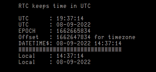

Still goofing around with a clock.
And now that I'm a bit more comfortable with MMBASIC and having found EPOCH() and DATETIME$()... my code just got a LOT simpler.
This is only a couple of lines of code to create this.
So... THANK YOU!

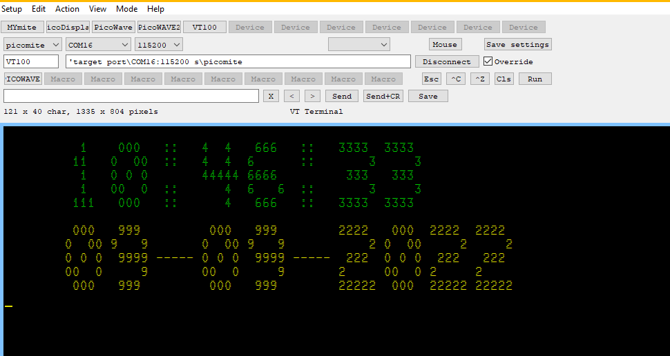

More progress...

I'm not sure how much this will help at this stage of coding.  I currently pull time from RTC every 10 minutes to update the internal time-keeping.
I will say that moving to the use of UTC and EPOCH time changed things for the better.
