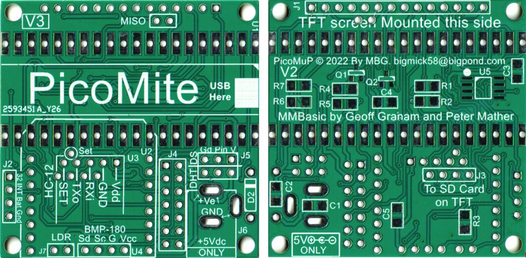

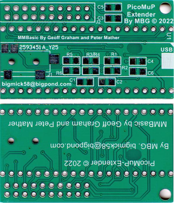

The PCBs are 3 part, as follows:
PicoMuP  (50mm x 50mm)
PicoMuP is the main Board for both the TFT and VGA versions of Pico-MMBasic.
The main board is designed to mount onto the back of an SPI 14pin TFT module and has support for the following features:
Header for 14pin SPI TFT display
DS3231/2 RTC chip
Header for DS18B20
Header for DHT22
HC12 wifi Serial
ESP8266-Mini (aka NodeMCU D1-mini) internet wifi
BMP180 header (barometric pressure and temperature)
Expansion header for Pico-KB-VGA
2.1mm Barrel Jack for 5Vdc centre +ve power input.

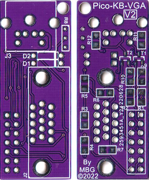

Pico-KB-VGA (20mm x 50mm)
Pico-KB-VGA, as its name suggests is a plug in PCB that has the circuitry for the VGA output and PS2 keyboard input. There is a 14pin (2x7) header that connects Pico-KB-VGA to PicoMup.
PicoMuP-Extender (50mm x 28mm)
PicoMuP can be used with BOTH the TFT and the VGA versions and provides a 20pin header with most GPIO plus 5V, 3v3 and GND. for connection to external devices.
The PicoMuP-Extender is designed to solder directly over the top of the Pico-Pi board via male header pins, This allows it to sit low enough that the PicoMuP-KB-VGA can `swing' over the top of it and not foul it also provides a 3.5mm stereo Audio jack for sound.

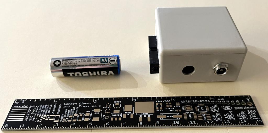

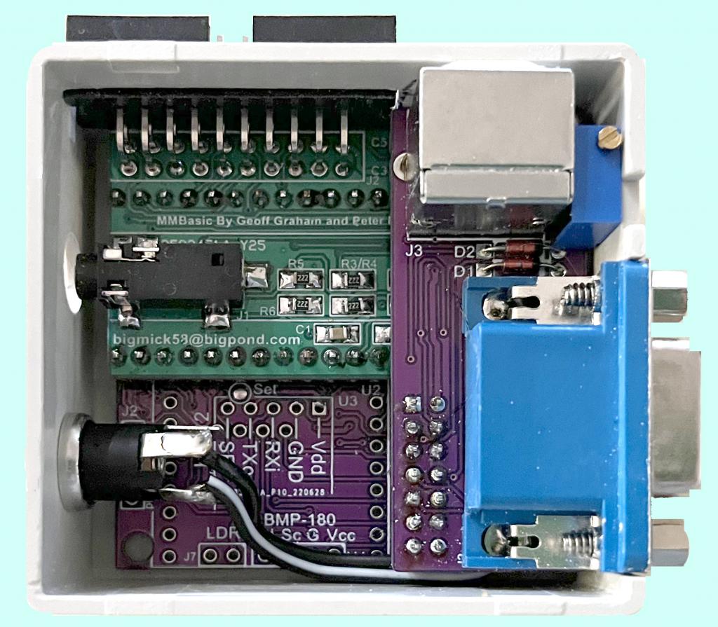

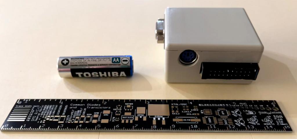

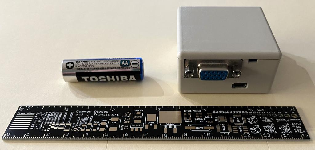

Anyway, My pet project has been to try to create a mini Pico-PC using the above mentioned PCBs and create as small as possible Pico-PC.
I found these nifty (and dirt cheap) boxes on Aliexpress for about $3AU for 2 shipped, crikey I couldn't pay the postage to the next door neighbour for that price.
It was a tight (Read that as VERY TIGHT) fit to get it all in but this is the final result.

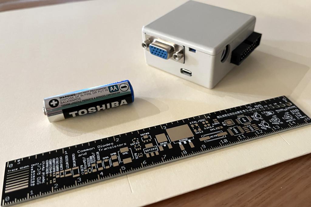

As can be seen in the pictures the Pico-PC is a little larger than a AA battery.
Also I do not `yet' have a manual for the PCBs and may not end up doing one as the builds are fairly self explanatory, I do have all schematics and parts overlays ov course and can supply them.

Thank you for your comment. It is honestly amazing how small it is when you actually see it.

What a neat and tidy (and powerful) package. Congratulations on fitting it all in.

I wonder if the kit comes complete with a small hammer for getting it into the case?
Posted: 09:43am 28 Jul 2022
Hi Mick,
I think you need a more powerful hammer to get it in that tiny box.
Once I get a few projects out of the way I will create a “how to” document on fitting it in the box.
It all went really well until I tried to squeeze the header out the back.
If the 20pin header is soldered to the extender board it is nigh on impossible to to get the header out the hole in the back whilst at the same time getting the extender board over the header pins on the Pico-pi (even with them cut down to bare minimum to allow the board to be soldered to the Pico-pi.) I did it but I had to open the height of the header hole about 1mm plus use a bit of ‘gentle persuasion’.
In retrospect I think it might be better to put the extender onto the Pico-pi (not solder yet) then try to rock the header in from the outside and solder the pins from the top once the header is in the extender. A needle point tip would be a must.
Another idea is to fit a vertical female header to the extender and then the R/A header can be popped into the female one and the opening for it can be higher up to be level with the top of the case.
If I build another one I will explore these options and document the entire process so others can have Pico-PCs as well.
