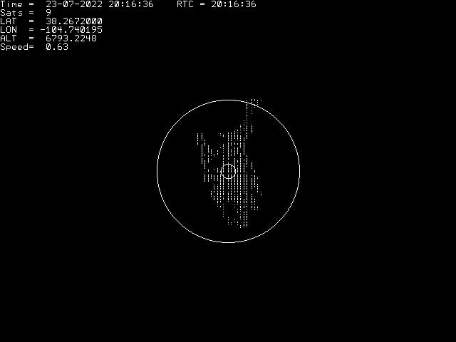

Here is an example Plot on PicoMiteVGA
This was taken with the GPS receiver in my basement work-room where reception is very poor and the WAAS data is not received.  The scale is 1pixel/foot and the small circle is 10ft radius with the larger circle at 100ft radius.  You can clearly see the "granularity" in the position data.
-Carl

  Sasquatch said  Here is an example Plot on PicoMiteVGA
Interesting plot Sasquatch, are you able to upload the code that generated this plot please?
