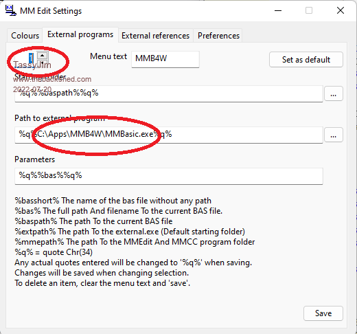

Assuming MMEdit V5,
Menu Action/Edit list...
Copy my settings but change the path to your copy of MMB4W.
Remember to SAVE
If you want to default to MMB4W instead of the original MMBasic.exe,
hold the shift key while selecting from the menu.
After that, the "run in DOS" button will be changed to your selection.
The first time you run it, there may be a delay while Windows AV has a think. After that it is instant.

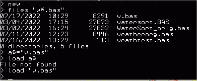

When I LOAD XXXXX$ or variations of it
I get "can't open file".
What ever is the problem it is going to be silly. I'm very good at that.

Posted: 11:40am 20 Jul 2022
  PeterB said  When I LOAD XXXXX$ or variations of it
What do you get from:
RUN "foo.bas"
or whatever the file is called ?
And which version of MMB4W are you running ? early versions probably copied the CMM2 and didn't have a LOAD command ... somewhat (pleasantly) suprised the current one (5.07.03b10) does.
