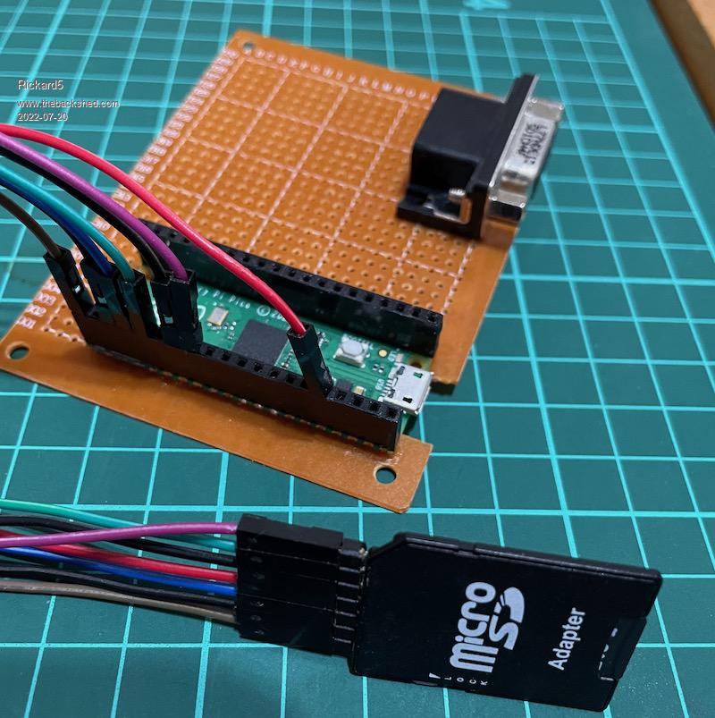

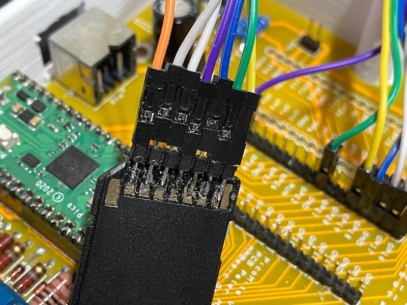

Somewhere I found enough information on hacking an SD Card directly to a Pico and did it successfully with :
OPTION SDCARD GP22
Unfortunately I had a situation and the card came disconnected from the pico and I cannot find that info again, does anyone know where I can find a hookup diagram

I've got no idea of the connections but, given the clarity of your photo, can you track the connections down by following the coloured jumpers?

Rickard5
Joined: 31/03/2022
Posts: 463
Posted: 12:31am 20 Jul 2022
Unfortunately I used 2 Black wires And I can't track them down though the mess

Posted: 03:42am 20 Jul 2022
OK SO I'VE WIRED WORKING FROM THE BEVEL
         - no connection
gp16 - CS
Gp17 - SDI (MOSI)
Gnd - GND
3v3 - 3V3
Gp18 - Clock
GND - GND
GP19- SDO (MOSI)
         - no connection
But the real question is which is the mosi and which is the MISO ?
and I reflashed my Pico with picomitevga5.07.04rc3.uf2 and when I do "option SDCARD GP16, GP18, GP19, Gp17
I get "Error : Pin 21 is in use" returned

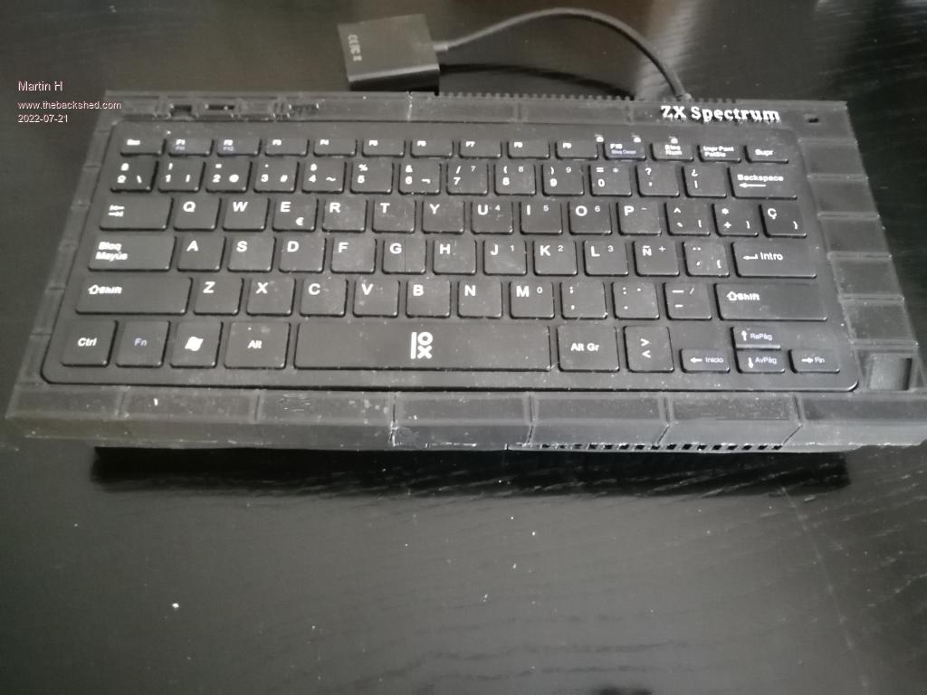

Martin H.
Joined: 04/06/2022
Posts: 1574
Posted: 09:31am 20 Jul 2022

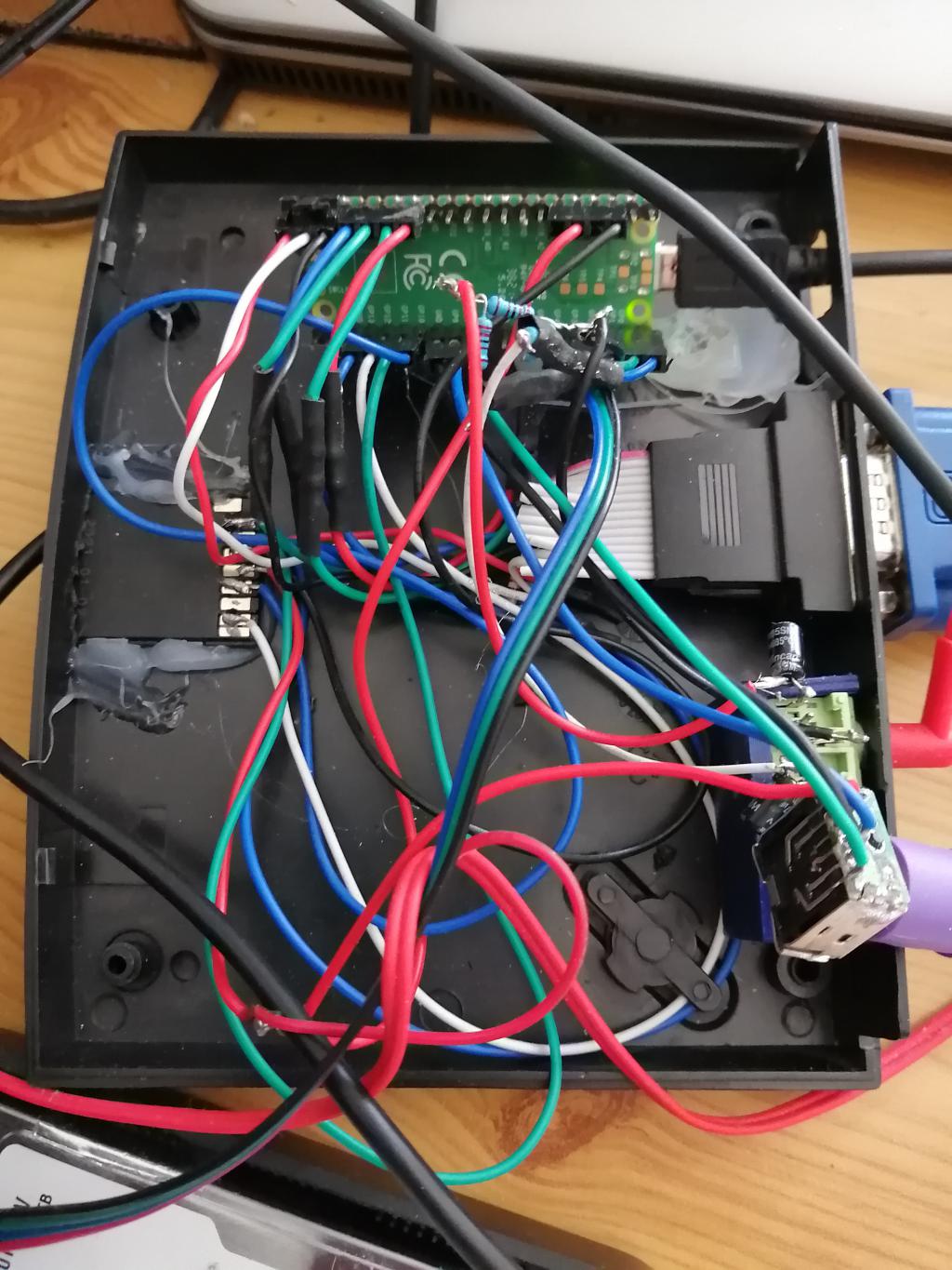

Works fine in my "Prototype"
ugly but a New Case (for the counterfeit PicoGame Board)is in Progress
'no comment

Martin H.
Joined: 04/06/2022
Posts: 1574
Posted: 11:19am 20 Jul 2022
not Ali Express ...
I build the circuit, according to the plans, on perforated grid board
and this should fit in the printed Case
so the feather in your cap has to wait ;-)
Edited 2022-07-20 21:21 by Martin H.

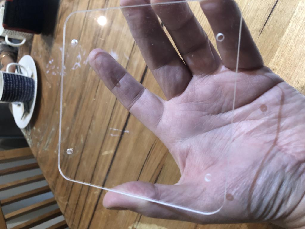

... and @bigmik has successfully machined me a 3mm case in clear acrylic (just top and bottom) for my 1.4 PCB, photos when I have them.

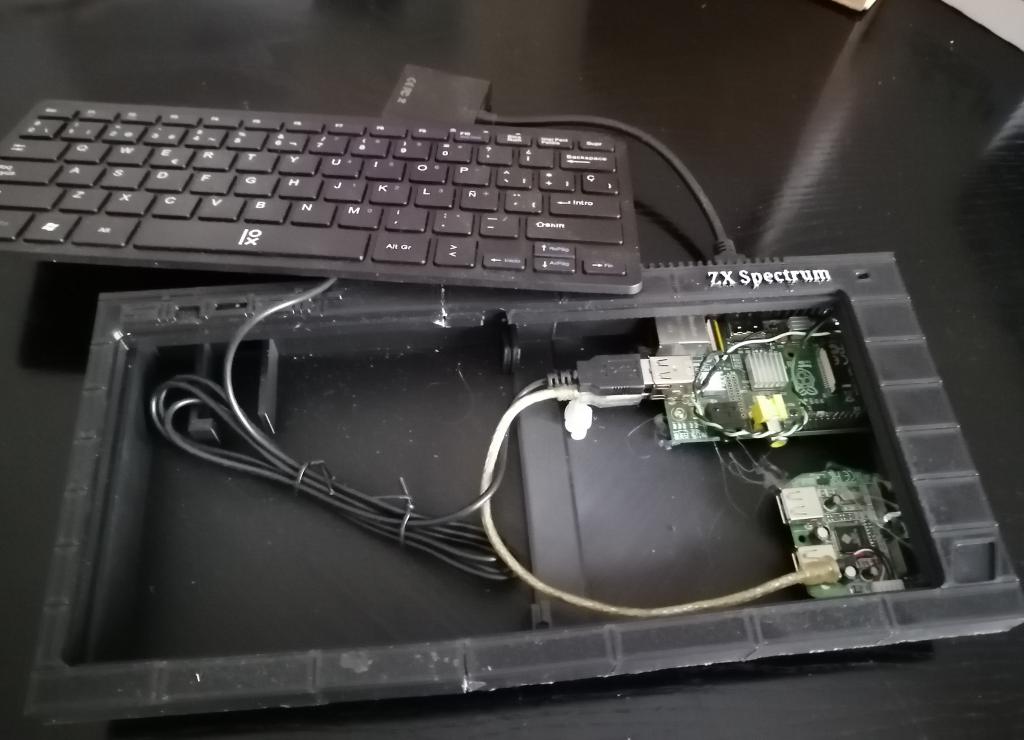

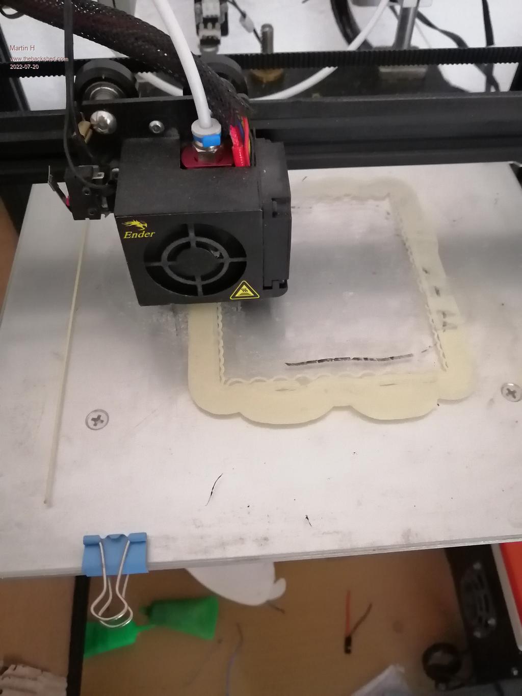

Martin H.
Joined: 04/06/2022
Posts: 1574
Posted: 02:02pm 20 Jul 2022
  pwillard said  There is a case?  Where?
it will be a modded Version of this one:
https://www.thingiverse.com/thing:1496674/files
(still printing)
