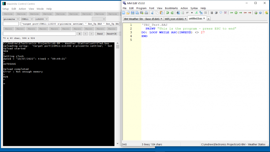

Here is some simple code:
'TBS_Test.BAS
 Print "This is the program - press ESC to end"
Do: Loop While ASC(inkey$) <> 27
END
Here is the screen shot:
You'll see that is fails the load and has nothing to RUN.
LISTing reveals nothing has been saved (not surprising).
Cheers,
Andrew

Posted: 06:33am 10 Jul 2022
Line 105 of MMCC.inf has a lot of extra text.
Delete everything after settime\ and see if that makes a difference.
I will have to work  out how that happened.
At a quick look, I can't see anything else that's a worry.

Posted: 07:10am 10 Jul 2022
I think the problem is caused by my less than idea way of trying to cater for all possible line endings.
I have used something more robust in the recent work but need to retrofit it to the other locations.
For now, I will chop the line of after any additional ' marks.
Thanks for be a test bunny.
