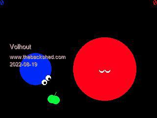

An update for the Circle game: Circle2.
The game still requires 2 NES controllers connected to the VGApicoGAME board.
The game is fast paced game for 2 players. Target is to eat apples and grow in size.
Tactics can keep opponent away from food. The player who moves when colliding into the other looses weight...
Win counter in top corners.
All graphics are circle commands (hence the name....)
Please enjoy....

Posts: 6199
Posted: 07:54pm 18 Aug 2022

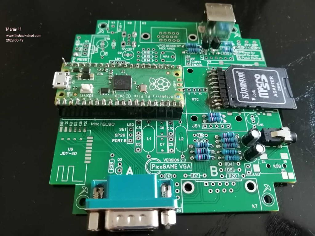

Martin H.
Joined: 04/06/2022
Posts: 1573
Posted: 09:08am 19 Aug 2022
Your Listing is very helpful from the educational perspective, to see how Piones is applied in practice. For this reason alone, I am very grateful.
At the moment I am waiting for the delivery of right angle connectors for VGA and joysticks. Here, in the countryside, you don't have an electronics-part-store, so you have to order everything. But somehow, one get used to this .
Good to read that your wife and grandchildren share your hobby, or at least support you
Since my girlfriend doesn't share my enthusiasm for making music, programming and electronics, I don't have time for this on weekends. My daughter is just as crazy as I am, but she hasn't lived with me for a long time. So you are right, "Single port it is" .
Tot ziens
Mart!n
this is, how far my work on the PicoGameBoard has progressed till now.
Edited 2022-08-19 19:22 by Martin H.

Posted: 02:17pm 10 Aug 2023
Slightly modified version for MMB4W.
On holiday only a PC with MMB4W...so all focus is on that...
