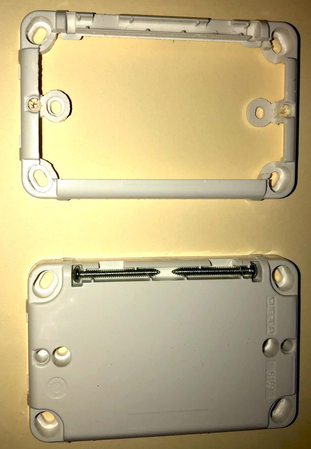

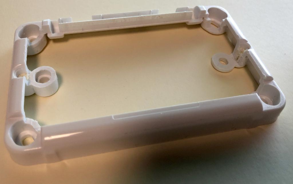

Rear Panel before and after cutting (take the screws out before milling just in case):
Here is a view showing cut outs on Rear Panel:

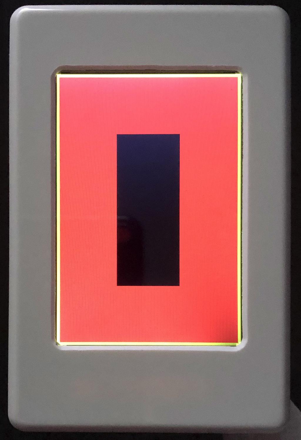

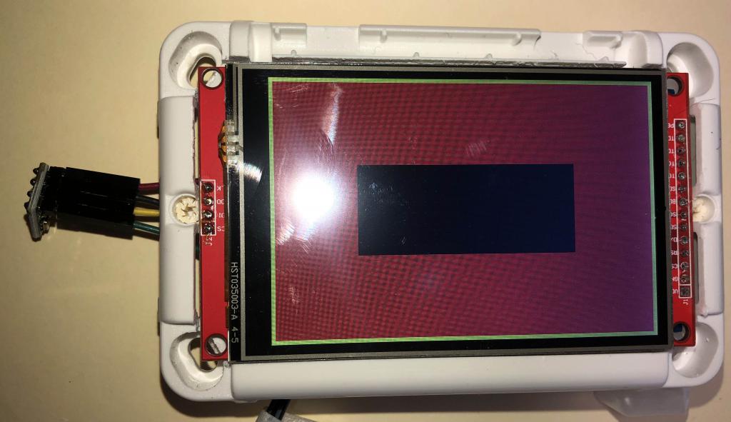

Here is the display fitted into the rear fascia, there is about 0.5mm movement so it sits very well and self locates (within the 0.5mm)

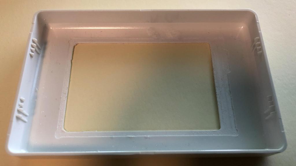

Here is a view of the inside cut for the front fascia: Note I also did a shallow cut around the viewing window and a small knock-out to allow the Touch cable to not get crushed, this allows the screen to `self centre' well that's the theory.

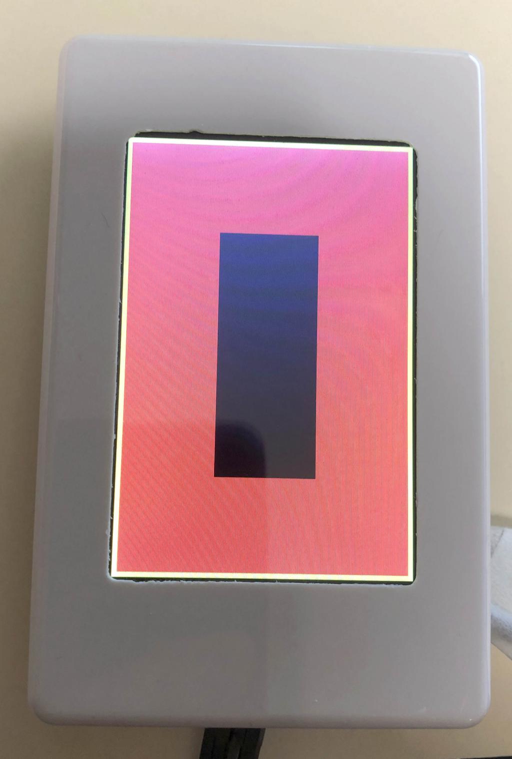

Here it is fully assembled: (I drew a yellow box with a red on inside it to show the limits of the display.)

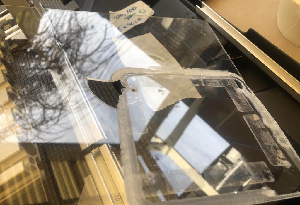

I am getting a bit of 'chatter' with my CNC (an el-cheapo 3018) and the material is made of PolyCarbonate which is quite brittle hence you can see small chips around the viewing window.

I used a 3mm 4 fluted spiral router bit and the origins are set so that the CENTRE of the cutter is directly over the intersection point of the 2 guide rails I fitted to my waste-board. (I previously cut 2 x 10mm wide channels and used some 10mm U-channel to act as guides). I push the fascia fully into the intersection point of the two guides and secure them.
With the front Fascia I secured it with some double sided GEL tape (face down) and it seems to hold quite well. The Z origin is set so that the cutter just touches the centre point on the inside of the face.
With the Rear Fascia I screwed it down in the four corners (face UP) and it seems to hold quite well. The Z origin is set so that the cutter just touches the centre point on the top of the face. NOTE! BEWARE! the RHS screws need to be small head I think mine are 5mm dia and the need to be screwed at the outermost extremity of the elongated holes so that the cutter will miss them, The LHS holes are fine as there is clearance of about 4-5mm)
Re. The LHS screws, SMALL head and the top hole screwed as HIGH as possible and the Bottom hole screwed as LOW as Possible. It is the Y-direction of cut that could hit the screw heads.

Suggest you try a single flute cutter. The key thing with plastics is clearing the swarf and a single flute is much better at this. Spindle speed should be as high as possible without causing any melting

I did initially try a single flute cutter but because of the roughness and slight chipping I went and bought a 4 flute.
The results were much of a muchness, Cutter speed is as high as I can get it running on the stock motor, I set to 10000 RPM but I don't think the motor actually runs at that speed, (Maybe its time to test it with a pic and phototransistor), I think the biggest issue is cutting Polycarbonate it is very brittle.
I am thinking of cutting from the front instead of the back for the view window but I would have to use clamps and I am still nervous about them and it might flex the fascia.
Anyway thanks for the advice I might try the straight flute again as I have changed my speeds and depth of cuts since I changed over to the 4 flute.
Another Idea I have is to cut the view window 0.5mm smaller and have to finish off by hand.

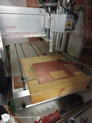

I cut some wall plates some time ago, I was using 2.8" lcds , see my posts here , I think I used similar wall plates, I can dig out the CNC details with cad files etc if interested. Mike

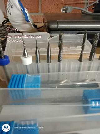

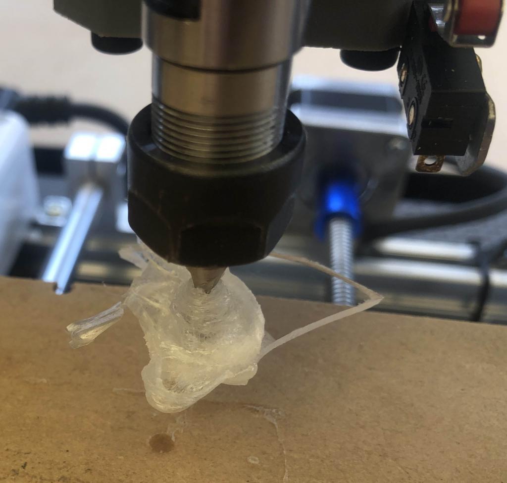

Hi Mick, the trick with plastics like acrylics, HDPE etc is if the cutter gets hot and melts the plastic back on to the work. So you need to use high feed speeds to the low rpm (relatively) and also small cutting depths. My mill is a bit bigger than yours and i have a 800w vfd which will do 24000 RPM but you should be ok with yours just have to experiment with feeds and speeds.
I use 3mm single flute up cut end mill, Try Adams bits here
I use CamBan for a Cad program, I have attached a Zip file with all the files for the project you won't be able to read the CamBan files but all the generated Gcode files are there which you can open in an on line viewer , this one is easy. Actually CamBan has a demo so you could look at the files. There was a lot of operations from memory to get the desired result but they worked out OK.

Mick, I had a look at your NC files, viewed them in candle, I cant see why the spindle has cut a little further into the corners of the face plate, unless there is some backlash T8 nuts, but that can be fixed a bit.
For rounded corners it would need to be drawn in the original 2D drawing, Inkscape or what ever.
The surface the end mill has cut, looks a little rough like it has grabbed due to heat, it might help having some compressed air cooling it while running, its what I will have to do with thick perspex cutting....have one of those air brush compressors might do the job.

Hi Aaron those corners you are referring to are intentional i believe they are "overcuts' they are for where a recess for instance is to receive an item with square corners to ensure it will actually "fit" into the corner which would other wise be round , the shape of the tool.

But quickly, each corner of the shallow cut is so the sharp corners of the glass of a TFT will sit, otherwise the corners would be round and the TFT could not nestle into the the cutout.
Also I don’t seem have issues with melting, in fact the cuts seem to peel off relatively cleanly, albeit the swarf is sometimes still attached to one side of each cut and needs to be trimmed off. No sign of melting.

Be cautious using any cutting lubricants with some plastics, particularly polycarbonate. We performed tapping operations on polycarbonate under water. (UHMW, PVC, nylon, acetal are generally fine.)
As Revlac posted, compressed air is definitely your friend, to evacuate chips and cool the cutting zone.

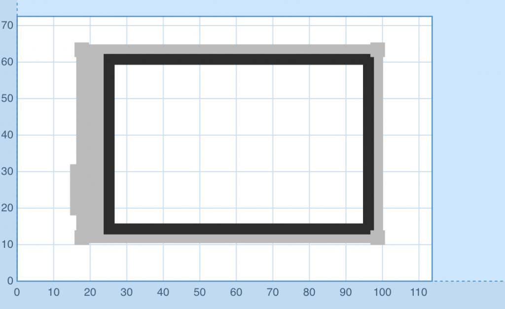

The cuts in the corners are by design, I made the recess 0.25mm deep and with 0.25mm play along each side so that the glass of the TFT would `self locate’ as the glass has sharp corners I needed to `knock out’ the rounded corners.
Here is my Easel design, the grey rectangles are currently 0.2mm deep the black 1.3mm deep (ie cut through completely). You can clearly see the small squares I use to knock out the corners. There is another one to provide a bit of clearance for the touch ribbon cable.
