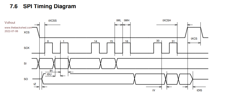

VC1011e data sheet is Here - That's quite some chip!
I trust you aren't using VS1001 compatibility mode, Alan?
XDCS is SPI CS
SCK is clock
SI is connected to MOSI / SPI OUT on the PIC
SO is connected to MISO / SPI IN on the PIC
I suspect you might need to run SPI in Mode 1.
SPI frequency should not be higher than CLK1/7. Better a bit lower so probably no higher than about 3MHz as the minimum internal clock (CLK1) is 24MHz.
