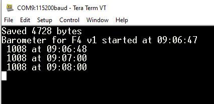

I can report you are indeed correct, I can access the BMP180 whilst still having the SYSTEM I2C setting.
Note that this was some old code written by AndrewG for the F4 (I didnt change the print string) but what I am happy about is that the BMP180 reads perfectly.
Thank you all for the quick response and leading me along the correct path.

Posted: 12:44am 07 Jul 2022
Hi Lizby, All,
As I said it was code I got from AndrewG and he has stated he got it from TassyJim and he stated..... (I was going to say he got it from Johnny Walker.. Ohh I just did say that.   )
Anyway here is the code I used
