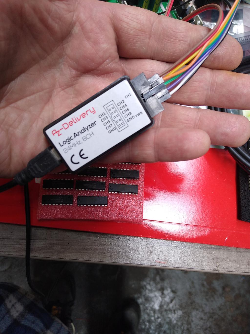

We talking about this thing?
I grabbed one, thinking I needed it but had solved the problem before it arrived.
What's the best software to get?
Craig

@Craig,
Yes, that is the thing.
Software: 1.1.34
I know this software works with the unit you have. The later (1.2.x) versions, somewhere there is a change that does ot support the cheap chinese stuff anymore.
