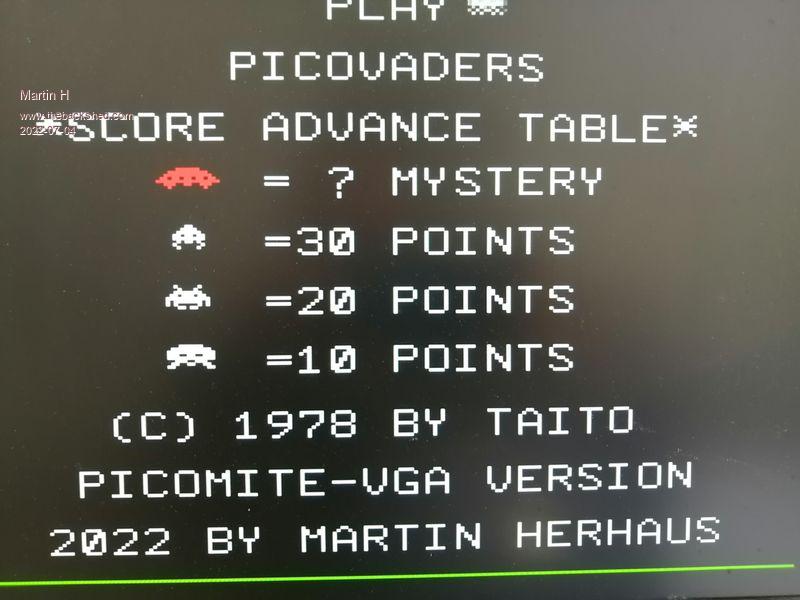

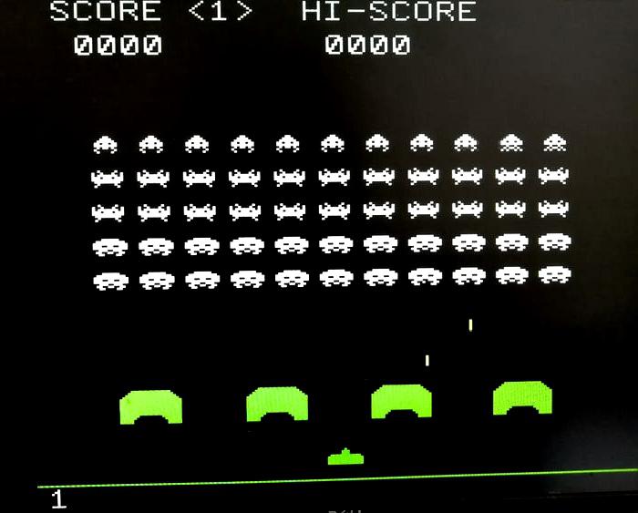

My first try of a complete Game in MM Basic on Picomite VGA
Use Cursor Keys to moce and Space to fire
If one would extend it by Joystick - Routines, you are very welcome

To the game....
Firing goes well. But moving the gun around is not. This is terribly slow.
I tried to increase the movement, but then the cleanup of old position of the gun is not correct.

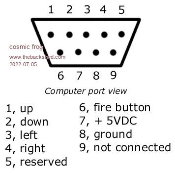

Atari joystick pinouts.

  cosmic frog said  Atari joystick pinouts.
That's correct and matches the layout of the PicoGAME VGA controller ports, but the question here is about the pins on the Pico, not the pins on the controller port - see the schematic linked above.
Also note the Pico will be driving the joystick at 3.3V not 5V, apocraphally that still works - I can't personally confirm as my AliExpress (clone) Atari joysticks are still in their packaging.
Edited 2022-07-05 20:03 by thwill
If the joystick only uses U,D,L,R,Fire all the joysticks I've seen don't need a voltage.
The ones that do need a voltage are those that use extra buttons and usually have some kind of shift register inside.
Dave.

  cosmic frog said  If the joystick only uses U,D,L,R,Fire all the joysticks I've seen don't need a voltage.
Dave.
ACK. I was only pointing it out because your pinout showed a 5V pin, whereas the same port/pin on the PicoGAME VGA is at 3.3V.
