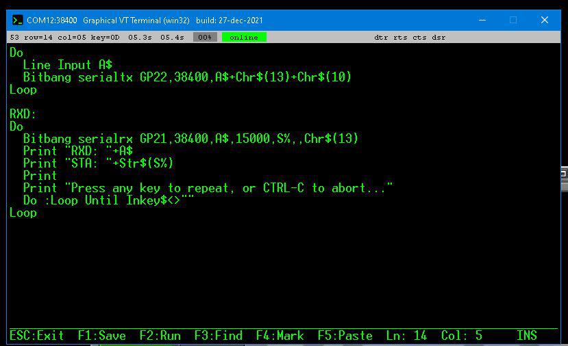

BITBANG SERIALTX pinno, baudrate, ostring$
BITBANG SERIALRX pinno, baudrate, istring$, timeout_in_ms, status% [,nbr] [,terminators$]
e.g.
BITBANG SERIALTX 4, 115200, "Hello world"
BITBANG SERIALRX 5, 115200, a$, 10000, s%, ,chr$(10)
status% returns:
-1 = timeout (NB: use len(s$) to see number received)
2 = number of characters requested satisfied
3 = terminating character satisfied

EDIT: The serialtx one seems to work perfectly.
Have tested a few baudrates up to 115k2, all of which are working fine.  Not sure if there is an upper limit to the baudrate?
I will have a play with the serialrx one now, and will post back with results.
EDIT: Serialrx also works beautifully.
