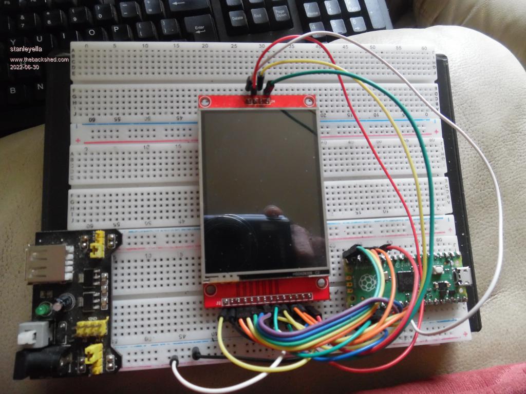

Hi. I just bought a rpi pico and have tried 4 ILI9341 glcds using picomiteV5,07.4.uf2.
The test lcd display displays coloured circles.

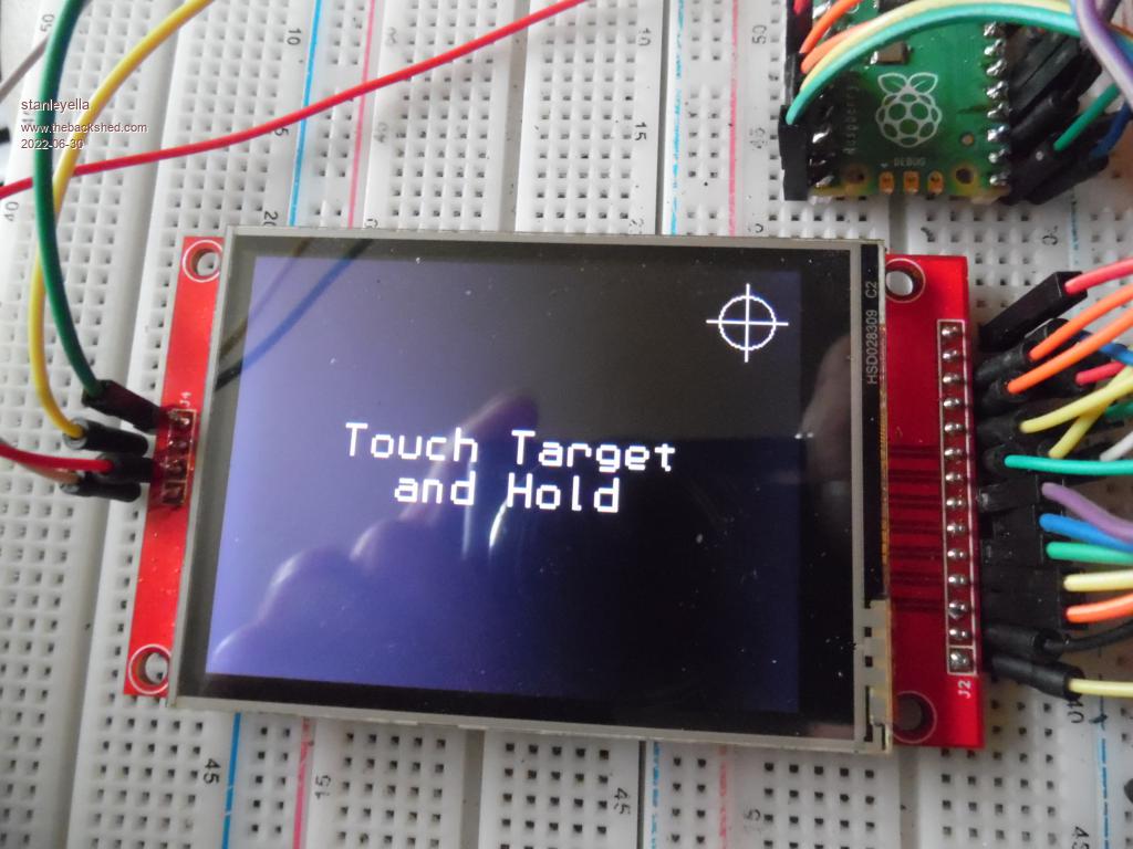

The gui calibrate either displays a target top left but touching it does nothing or on another display touching the first target draws another target top right and touching that print error touch hardware in the terminal.
Any issues with ili9341 touch screen?
cheers.

Thank you for replying. The displays have the XPT2046 and I have used the 4 ili9341 with great cow basic no problem apart from they are 3.3V logic and the 328p uno/nano boards are 5V logic. They work but touch was not perfect but pretty good.
It detects the first calibrate target then the next then fails??
I'm new here.. can videos be posted or youtube links?
I only found about rpi pico and mmbasic from a youtube explaining computers.com so it's new to me but I have a rpi1,2,3,400 but I never learnt c+ or python.

This because it is seeing the same coordinates for both. i.e. it isn't reading properly. Check that SDI(MOSI) is connected to T_DIN and SDO(MISO) to T_DO and SCK to T_CLK. Then all these should be connected as per the OPTION SYSTEM SPI command. If it responding to a touch then it is seeing T_IRQ but check T_IRQ and T_CS are specified correctly and the correct way round in OPTION TOUCH.
The ILI9341 code has been around forever and is completely reliable so it must be a wiring error
Make sure VCC is connected to 3.3V and not 5V
Edited 2022-06-29 22:57 by matherp
