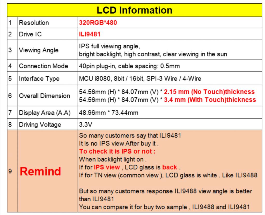

The display’s PCB looks identical to the ILI9488 board at least from the visible Rear side.
The description states SPI 3/4 wire ( see the table)
The ILI9488 that works fine states it is SPI 4 wire so there may be a difference there.

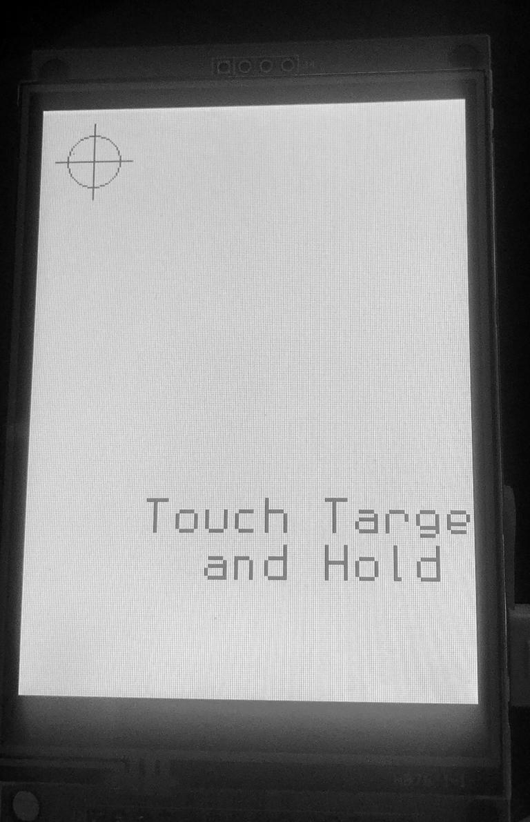

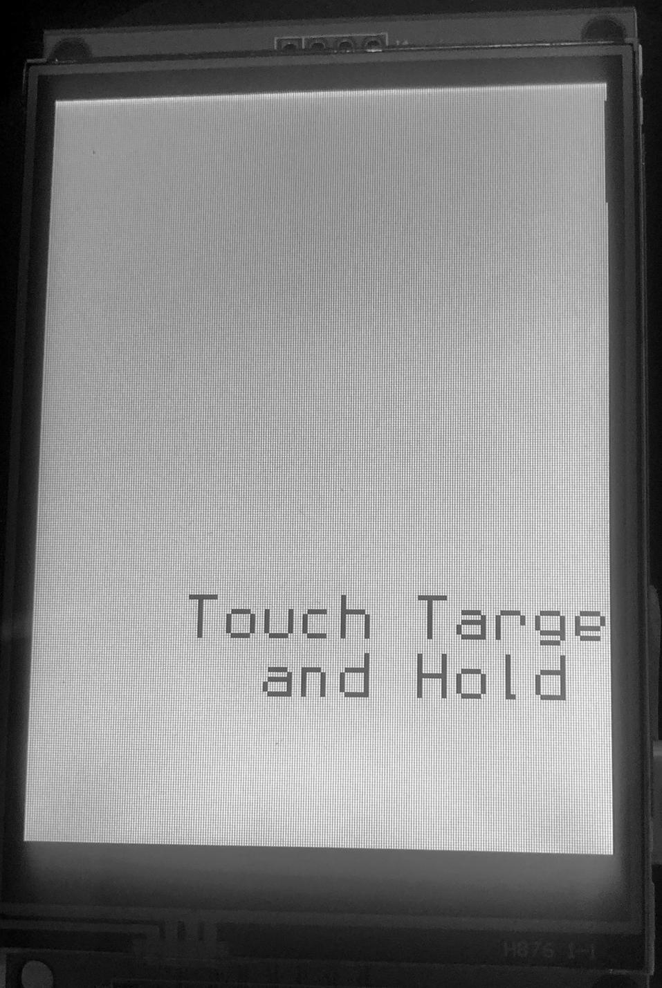

Using the ILI9488 setting string below gave some promising but not perfect results
OPTION LCDPANEL ILI9488, PORTRAIT,GP15,GP14,GP13,GP20
The screen goes full white (And changes intensity as it should with the BL commands) which is the first time I have ever seen it more than a black screen
I tried a GUI CALIBRATE and the first point is displayed
Every other calibration point is off the screen and looks exactly the same, I press where the points should have been and they pass OK.
I notice the IMAGE is in NEGATIVE format, ie. what should be black is white and vice-versa.
Also it appears that the driver thinks the screen is twice the size (in resolution) than it is HENCE the text and targets being off screen.

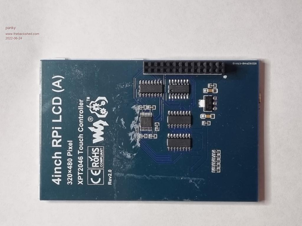

Can you post a picture of the rear of the display. I have both 3.5" and 4" RPi connector style LCDs working fine using the ILI9481 option on the Pico however I don't think either are IPS style as they come up black screen after briefly flashing white on power up. I just tie the BL to 3V3 via a 68ohm resistor - have not got around to attempting BL control.
Doug.
PS. Mine have 2 74HC4094 chips, a 74HC04 and a 74HC4040.

Further testing shows the screen fills with a box 241x321 in size as opposed to what it should be of 320x480
Also as I suspected the image is in NEGATIVE view
box 0,0,240,320,50,rgb(cyan)  GIVES a RED box
box 0,0,240,320,50,rgb(red)  Gives a CYAN box

Mine all appear to have the shift registers.
Doug.
Posted: 12:46am 24 Jun 2022
HI ALL,
BIGMIK is an IDIOT
I did the above tests with an ILI9341 display NOT the ILI9481
The ILI9481 still shows a blank screen no matter what driver I install.
So sorry for leading you all astray.
As to the brightness the ILI9341 showed up about 3 times the brightness of the ILI9488 so I thought it was the IPS display.
Argghh! Sorry fellas

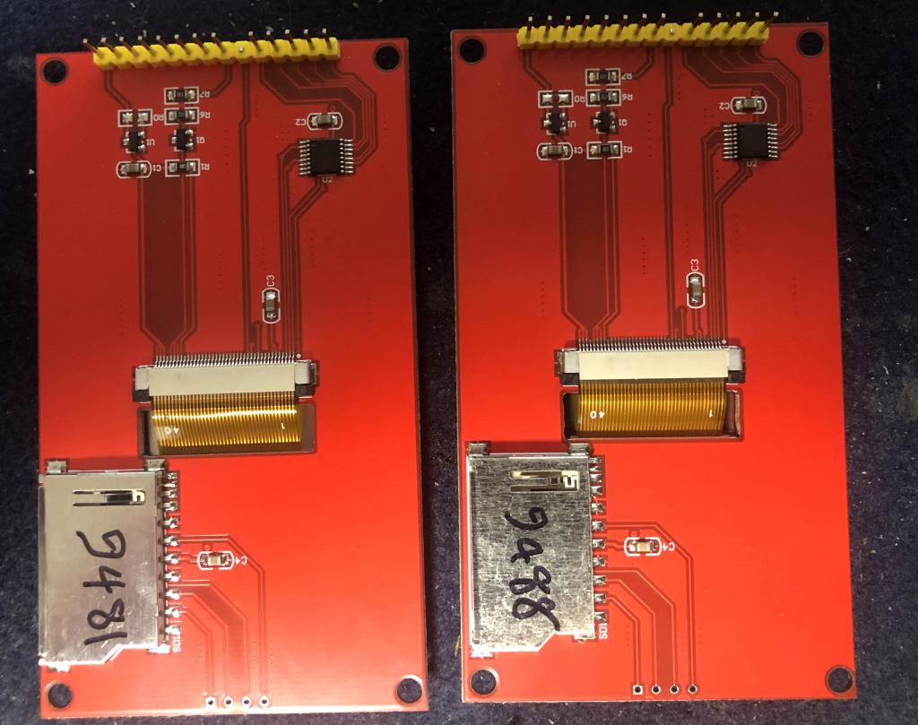

Hi Panky, All,
My ILI9481 (on the Left) and ILI9488 (on the Right)
As far as I can see the PCBs are identical.
