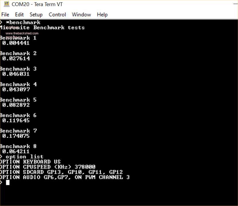

Bleep (Kevin Moore) has discovered how to underclock the flash memory on the RP2040 at boot allowing the system clock to run faster while still reliably reading the flash. I've then worked out how to make this flexible depending on the CPU speed.
Together these mean that we can now clock the PicoMite and PicoMiteVGA at up to 378MHz.
Testing the PicoMite at this speed I'm now seeing The simple speedtest showing more than 257,000 basic lines a second and grainbench at 6441
I've attached the files below for testing - please let me know if you see any issues on any peripherals (I2C, SPI, PWM, etc.)

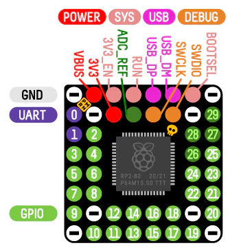

I don't know when the change happened but the keyboard pins seem to have changed
This is the NON-vga version, after a clear_flash, no other options
PicoMite MMBasic Version 5.07.05b10
Copyright 2011-2021 Geoff Graham
Copyright 2016-2021 Peter Mather
> OPTION KEYBOARD US, 0, 0, 0, 0
> SETPIN 11 , DOUT
Error : Pin 11 is reserved on startup
From the Manual:
The keyboard must be connected as follows:
Connect GP8 to PS2 socket CLOCK pin.
Connect GP9 to PS2 socket DATA pin.
I'm pretty sure I had a PS/2 keyboard working on GP8 and GP9.
And now it looks like GP11 is used.
I can't seem to find any mention of new pin assigments, are there more changes?
Posted: 08:12am 21 Jun 2022
There are no pin changes
GP8 == pin 11
Try
SETPIN GP11,dout == setpin 15,dout
fred777
Joined: 01/07/2021
Posts: 106
Posted: 08:17am 21 Jun 2022
Aaaaargh, I constantly get pin numbers and GP numbers mixed up... sorry
