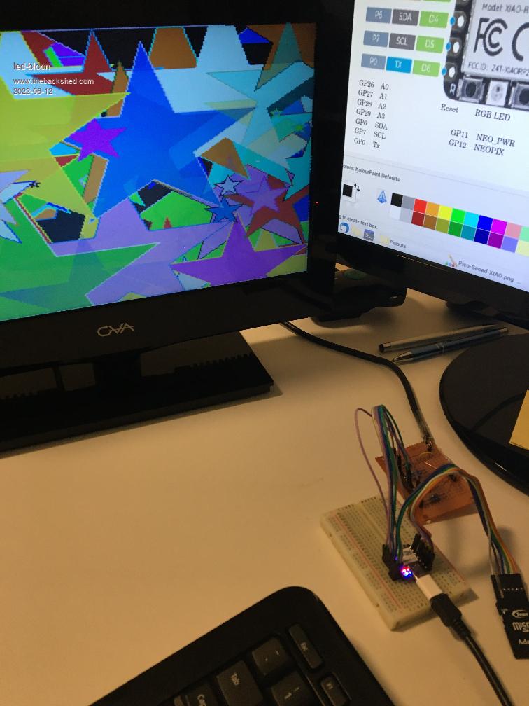

Posted: 11:16am 12 Jun 2022
  led-bloon said  Me three!d
That's mighty compact. Can you share a circuit diagram? Have you altered the MMBasic source? Great job anyway.
led-bloon
Joined: 21/12/2014
Posts: 210
Posted: 12:27pm 12 Jun 2022
The PicoMiteVGA software has been modified to match the XIAO GPIO pins.
As there was one pin short to add a PS2 mouse, I joined hSync & vSync
to form cSync in the software, freeing up the needed pin.
This works fine on my 16yo LCD TV and also on my 1yo Philips monitor.
(however it may not work on ALL [early] monitors)
Device  |   Pin  || Pin  |  XIAO  |    Pin || Pin    | Device
SDcard       5   || 1    GP26   5V0     14 ||
             2   || 2    GP27   Gnd     13 ||  3,3   SDcard,PS2
             7   || 3    GP28   3V3     12 ||  4,4   SDcard,PS2
             1   || 4    GP29   GP3     11 ||  Green2 VGA
PS2 Clk      5   || 5    GP6    GP4     10 ||  Red    VGA
    Data     1   || 6    GP7    GP2      9 ||  Green1 VGA
VGA       cSync  || 7    GP0    GP1      8 ||  Blue   VGA
VGA:
  Single O/P colour (Red & Blue)       330 Ohms
  Dual   O/P colour (Green)            390 & 1K  Ohms
  cSync fed into the hSync I/P of the VGA connector
SD Card:
  Using simple uSD card adapter with 3V3 supply
     __________________
    /  1 2 3 4 5 6 7 8 |
   / 9                 |
 NB Before setting Option SDcard, GP29 MUST be set to "OFF"
 (done once only)
 OPTION SDCARD GP29,GP26,GP27,GP28
PS2 Keyboard:
  My eMachine Keyboard uses 3V3 supply ok
  1 - Data
  3 - Ground
  4 - VCC (3V3)
  5 - Clock
Miss you George
Posted: 12:45pm 12 Jun 2022
Thanks for that. That's PCB worthy. Nice work. No sound and no controller, but heck of a job to provide so much with so little.
Posts: 3418
Posted: 12:52pm 12 Jun 2022
The composite sync is very clever.
For monitors that don't support composite sync a simple  R-C sync-separator could recover the vertical sync. For really obstinate ones an additional C-R  would remove the V from the H.
Could be useful to gain a pin on the regular PicoMiteVGA if Peter likes the idea.
