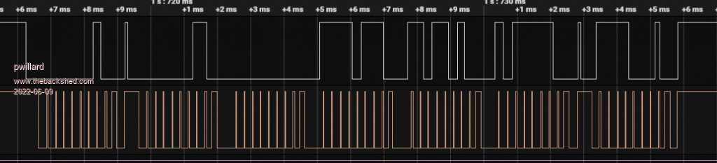

My latest challenge is to get this to work: TM1637
It's a bit tricky since it's basically a shift register (but not actually SPI) since it combines MISO and MOSI into a single bi-directional pin. It sends an ACK after 8 bits of sent data from the MCU. So, direction switching is needed.  I have the beginnings of the code done...  but the PICO seems up to the task of doing this handshake very "manually".

Follow-up:
Using the example code provided, with some quick edits and a couple of added 'pause 0.01' commands... I got it working on my Pico.  It was kind of gibberish until I added delays near the clock pulses.
You saved me a ton of experimenting and it's appreciated.
