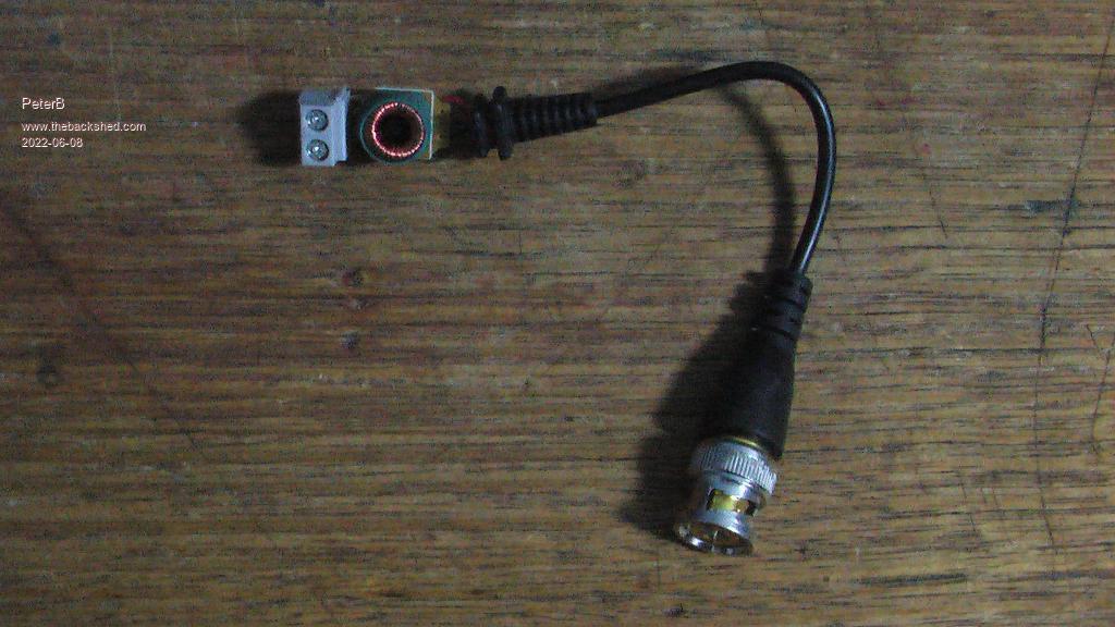

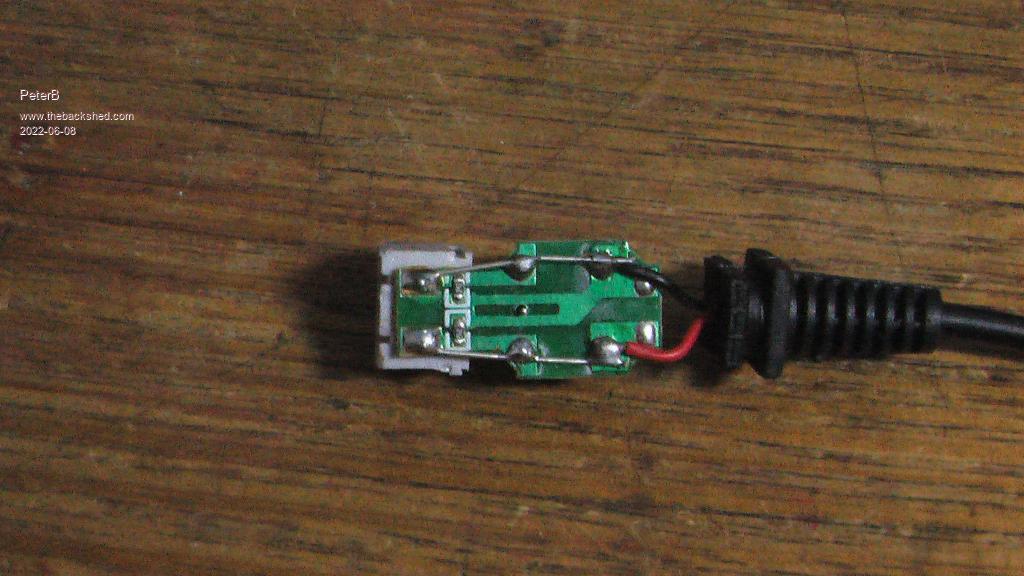

G'Day All
We have a CCTV system that has worked for some years but recently started displaying horizontal lines on one camera.
The 5 lines were caused by 50Hz interference.
After a process of elimination, it was this BALUN.
So how did it happen?
All I can think is that it was a factory reject, repaired by by-passing the transformer and sealed up. And so it worked for years until
one of the windings went OC and acted as an antenna or black magic does exist or ?????
I am also a bit concerned that there is probably another 11 still in the system.
A week later one of the 12V coaxial connectors went OC but on a different camera.
Peter(B)

The balun bypass is a sick joke, tbh.

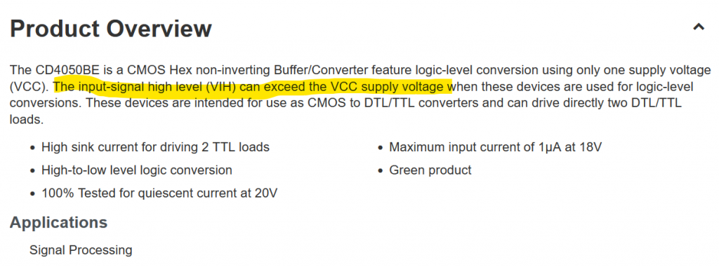

Posted: 06:07am 15 Jun 2022
Is there a CD4050U ? I know there's a CD4049U and IIRC that's an inverting version of the CD5050. AFAIK they all have protection diodes on the input as the input isn't supposed to ever exceed VCC.
I'd have to chase down some data sheets...

  Mixtel90 said  Is there a CD4050U ? I know there's a CD4049U and IIRC that's an inverting version of the CD5050. AFAIK they all have protection diodes on the input as the input isn't supposed to ever exceed VCC.
I remember a comment that was something like "be careful because the older CD4050s had a protection diode" but I left it at that.

Posts: 9094
Posted: 07:11am 15 Jun 2022
Found a data sheet. CD4049UB and CD4050B are identical except that CD4050B has an extra MOS pair on the output to convert it to non-inverting. The input circuit is the same, with protection diodes.
Yep - the diode to VCC is reversed so you can exceed VCC on the input.
The diode to gnd prevents the input from going negative. Then there is a series resistor (value unknown). You must limit input current to less than 10mA.
If you are having problems with them latching up it may be that VCC is too low or that there is too much input current.
