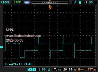

setpin 21,dout
setpin 22,dout
do
 port(21,2) = 1
 port(21,2) = 2
loop
1k resistor from pin 21 to point A
2k resistor from pin 22 to point A
I expected to see pulse changing from 1/3 to 2/3 vcc.
Waveform at point A shows brief (around 1 microsecond) periods when both outputs are high and also both outputs low. Waveform also shows occasional longer periods (around 15 microseconds) when both outputs go low. It looks like the pins are updated sequentially, and occasionally an interrupt separates the two updates.

I have done a bit of machine code programming in the past and could either change a port one bit at a time or do a parallel load, which changed 8 bits simultaneously. I thought the port() command would be like the latter. Mick, you are right, a capacitor would do the trick, and a few extra microseconds delay would not hurt at all. Without it the 3v spikes would cause false triggers on the device monitoring this output.

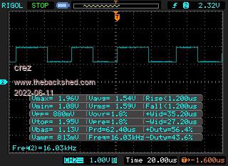

Just tried it. Have not been able to detect even 1ns difference when running the OP test program. This is marvelous !!! Can we have that please in all pico versions (also the VGA version).
Thanks a lot for making this possible. It opens a whole new area of possibilities.

Thanks Peter, I've never been referred to as the OP before .The Picomite version suits me. I will get a chance to try it on the weekend.
