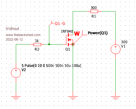

Posted: 03:33pm 08 Jun 2022

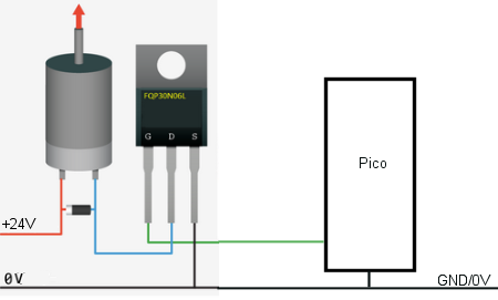

Found a graphic that is similar.
I am at 24V, though.
Strange this is, though, I pull the PWM wire away from the Pico and in free air, the FET starts conducting 4A(!!!)...Put my finger on the end of the wire where the PWM is supposed to go and the load current is reduced to ~2A...Clearly confused here

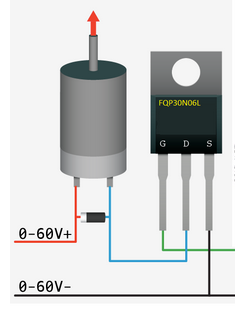

so in your circuit, you have +0-24V and -0-24V?
if the source is at -24V, the gate voltage will vary between 24V and 27.3V (relative to S). so when the pico is driving at 0V so the thing will always be on. This incidentally is a danger zone - rule of thumb, Gate voltage should be <20V
Edited 2022-06-09 01:56 by CaptainBoing

Posted: 04:05pm 08 Jun 2022
to avoid confusion, this is your circuit(?)
Edited 2022-06-09 02:12 by CaptainBoing

Posted: 04:11pm 08 Jun 2022
  CaptainBoing said  to avoid confusion, this is your circuit(?)
Exactly, except the load is resistive (heating element)
Posted: 04:19pm 08 Jun 2022
sorry I updated the picture between times.
absolutely nothing wrong with your design. precisely the same as my bed heater except I am at 27V and driving with a '170 micromite.
As mick said above, test the FET in isolation:
attach a wire to the gate and take it to 0V. Measure the voltage between D & S, it should be 24V (the FET is off)
Now connect the gate to 3V3 and measure the voltage between D & S - it should be (ideally) 0V (The FET is switched on hard... 3V3 is above VGSth of 2.5V and RDS is a few milli-ohms)
if all the above checks out, the problem has to be something with the way the Pico is driving.
connect the gate to your I/O pin and set it high then low. Do the checks again in each state. if all is OK then the problem has to be with your PWM setup.
