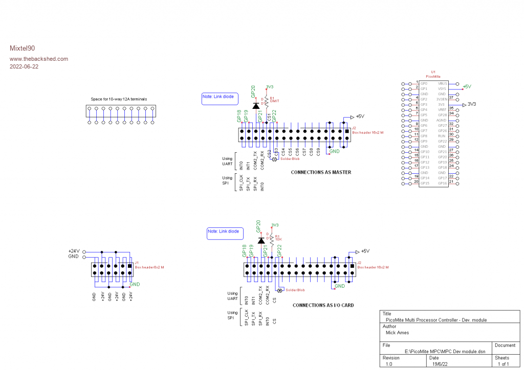

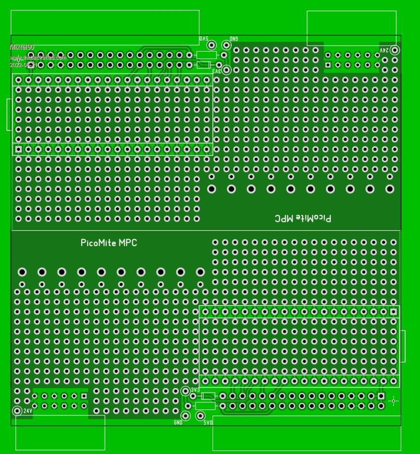

This is something else that started as a wild idea while doodling. It's a sort of design-in-progress that may or may not be attempted sometime. :)  I do these things mostly because they seem interesting. Every one is a learning exercise. lol

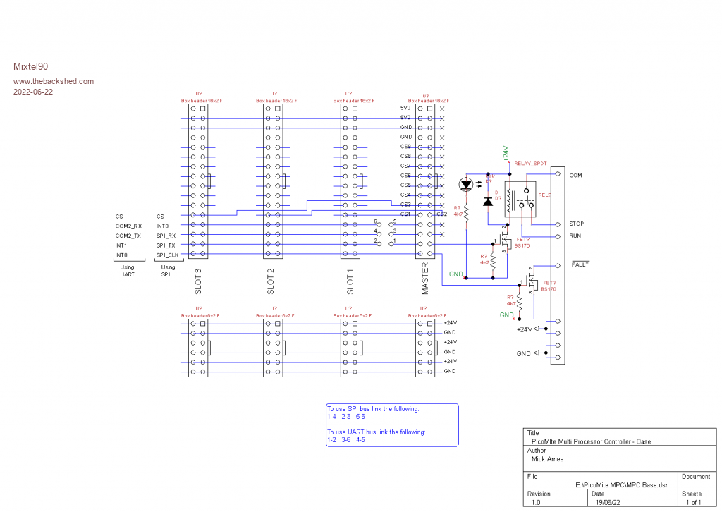

This is a logic controller system based entirely on standard PicoMites. A base bord holds a master controller and a number of I/O card slots (I refer to a 6-slot board as having a master + 6 I/O slots). The slots are on a SPI bus, with a CS line each. I've kept it to 9 I/O slots to give a 10-position baseboard. The base shown in the zip file is 100mm x 150mm with 6 slots, but you can get a 3-slot board in 100mm x 100mm.
Using addressable slots in this way uses a lot of pins on the master but gives fast access speed and means that there are no I/O board address switches to bother about. The SPI bus should easily be able to exceed 1MHz, with 10MHz not being unusual - I think that's quite feasible. SPI is handled very neatly in MMBasic so I think it's a good choice.

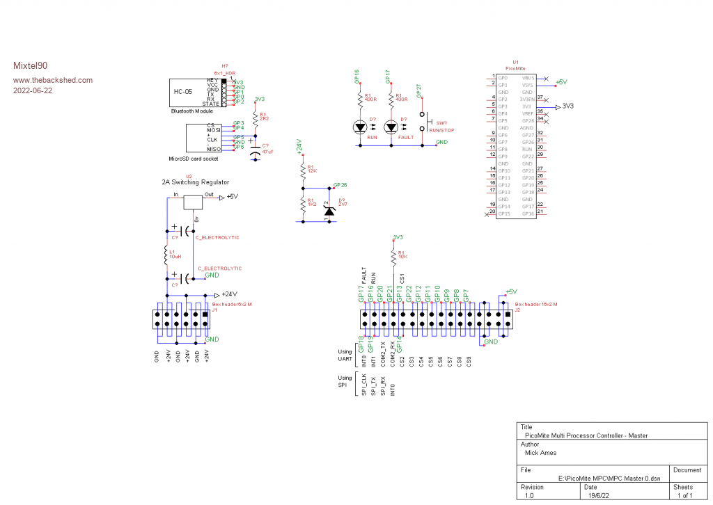

The master board also carries a buck converter (TBD) to convert the 24V board supply to 5V to feed the I/O modules from the bus. There isn't a lot of current required from 5V, and it means that you can't attempt to run the system without the master card. It has two LEDs, Fault and Run which are fed out to the base, where Fault drives a mosfet with the drain available to connect a beacon or something. The Run signal operates a small relay with a changeover contact giving Run and Off status. COM1 is fed to a connector that could be used for external monitoring or whatever. The master can also monitor the 24V supply to ensure it is within spec for modules sourcing 24V to external loads.

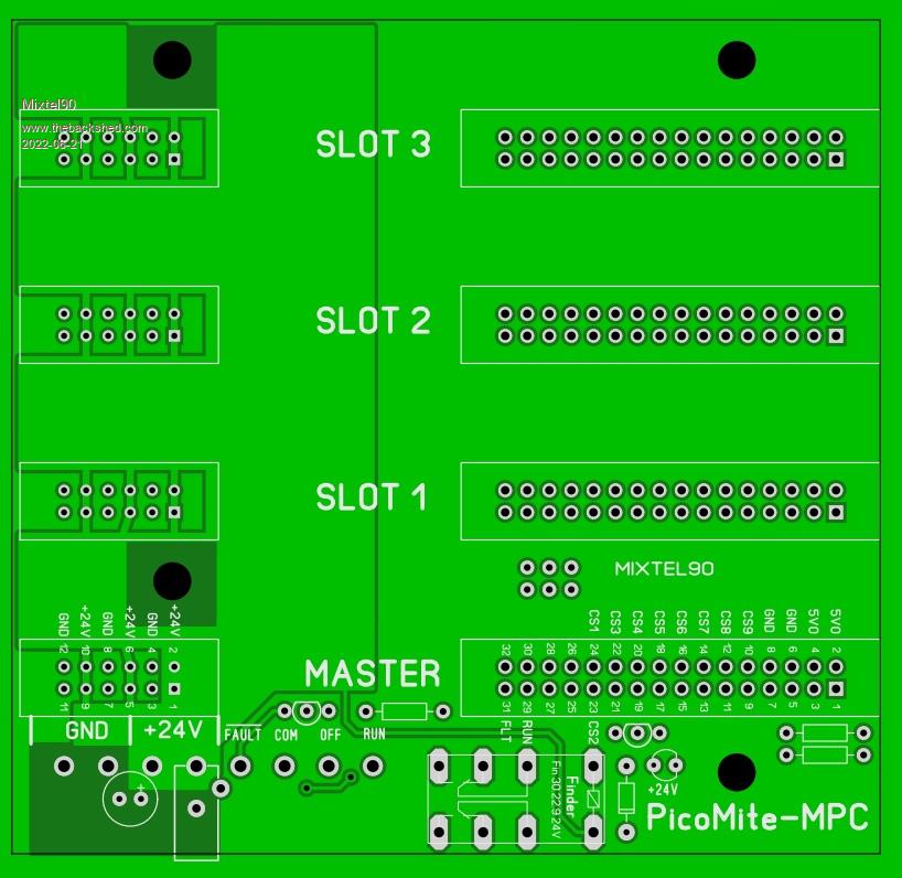

Each I/O board is 100mm x 50mm high and carries pluggable I/O terminals along the top. So, you can get a fully loaded 6-slot PLC into 150mm x 100mm x 50mm.
The number of I/O per board depends on complexity. At the moment I have:
5-way : Opto-isolated input, Monitored IS switch input
8-way : High-side 800mA digital out
10-way : Non-isolated low side digital out, Non-isolated digital in
A 6-slot base could, if you stick with just the 10-way boards, have 60 digital I/O. This is hardly earth shattering for the PLC world, but anything more would have needed bigger PCBs. The advantage of 100x50 is that you can get 2 out of a 100x100 "bargain price" pcb. :)
Note that nothing plugs in apart from the I/O boards into the base and the I/O terminals. This is for reliability. Also, there are no special chips used other than the Pico boards. This is important at the moment as delivery times for even simple relay drivers is silly if you want them from reputable sources. It makes the board much more complex than it needs to be, but hey - it's repairable and this is a hobbyist project anyway. :)

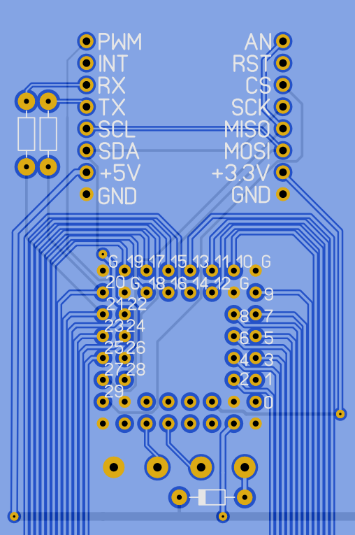

And we now have a 5-channel non-isolated analogue input card. Each channel can be independently set for 4-20mA or 0-10V. There are 5 indicator LEDs that can be used for anything - they are just PicoMite outputs. They could indicate high or low levels on each channel, or a 5-way bargraph for a single channel. I suppose I could add more...
I leave it to your imaginations how I got 5 channels. In theory it should work. :)
I often tackle a retrofit of a machine where the documentation is long-gone and somewhere along the way, I realise that I need one/both of the above due to some oddball sensor that needs to be supported...can be a real pain.
My solution to this and other possible surprises is to simply provide support for Click Modules
I have multiple channels of PGA-2040 + "Click Socket"
Craig
Edited 2022-06-01 16:30 by Tinine
Posts: 9265
Posted: 06:46am 01 Jun 2022
IN------+--[ 1K ]----+------- PICO
      ___          ___
     150R         430R
      ___          ___
       |   LINK     |
       +--o  o  o---+
   4-20mA           0-10V
PicoMite has LM4040 fitted, so range is 0-3V, 3V=20mA or 10V.
Switch another 1K in parallel (or another 430R in series) and you get a 0-5V range too.
0.6V input corresponds to 4mA. Resistors should ideally be 0.1%.
Edited 2022-06-01 16:52 by Mixtel90

A full size 9-slot board is now officially 100mm x 210mm. and a 3-slot is 100m x 96mm.
I thought I might do my own buck converter to get the 5V simply because of reliability in getting components rather than modules. However, the easy to use through-hole switcher chips seem to be out of stock - apart from the now obsolete (and expensive on ebay) MCI4575-5.0_T. :( . Still, there's no rush.

Posts: 9265
Posted: 06:29am 02 Jun 2022
I'm guessing that you are using a single output rail?
It's obviously a switcher. The first thing, is there enough load on the line that is being monitored for voltage? Only one of the +ve outputs will be fed back to the feedback to try to stabilise all outputs. It's usually 5V, but it can be 3.3V. (However, the newer motherboards don't often use those rails and take all their supply at 12V, using local switchers on the motherboard where needed.) If the load on the monitored rail is very low then the supply can, in some cases, be a bit unstable. If you are using the +5 output then try loading 3.3V a bit and vice versa. You probably won't need a lot of load, try around 50mA-100mA or so.
The miniature PSUs are almost always noisy. They rely on having a high switching frequency to reduce the size of any filtering components, which is fair enough, but in the effort to make everything as small as possible they sometimes skimp.You could try a bit of external RC filtering on the rail you are using. R will be needed to avoid too much capacitance on the output causing problems, but 0.5R or so may be OK. Also, they put noise on their supply rails, so make sure you have a good input cap as close as possible to it. It's usually 150-200kHz "hash" so bypass it with some low value ceramics. Don't go too big as the primary PSU might object. :) You could also try a ferrite ring or cable filter on the incoming cable to prevent radiation from it.
Tinine
Joined: 30/03/2016
Posts: 1646
Posted: 09:12am 02 Jun 2022
You hit the nail on the head, Mick. This is the one thing that concerns me
I want clean, stable power but am clueless regarding this. I come across trivial circuitry but the supply lines can have a slew of capacitors of various sizes.
Real estate is available on my board (150mm X 400mm) so I don't mind overkill for this but I have no idea what I need to do.
Is there a general guideline out there?
Craig
P.S. I have used these things to power the E-100 with my own motion control boards and they work perfectly. BUT those were emergency/panic jobs where I paid no attention to power quality.
Posts: 9265
Posted: 10:42am 02 Jun 2022
Do you want a single output supply? What current?
I've been looking for one to get 5V at about 1.5A from a 24V (nominal) input. There are commercial modules that will do it, but most are a bit higher output than I need and all of them are too expensive for my purposes. At the other end are the Chinese modules, but you can't guarantee any quality or that they'll be available for any length of time. That's why I've been looking at building my own using a TO220 switcher with a couple of capacitors, a diode and an inductor. The problem with that is availability at the moment. If you want more output current then you can use a switcher chip with external power device(s). These "simple switcher" things are all very similar. The main difference is that some are fixed voltage and some variable using a resistor or two.
You may be able to clean up the output from that supply. A scope will help in this as you really need to load the supply and watch what happens.
First - make sure you have plenty of available current input. Those things can draw up to 20A from the incoming supply if fully loaded. If they run short of current they are liable to shut down-startup-shut down etc.
If your incoming supply hasn't got a filter on the lead near the plug then put a few turns through a ferrite ring to stop radiation from the incoming wiring.
Watch your grounding. Don't put low current signals through the same conductor as a high current supply. They should only meet at one point - the output from the switcher.
If you want the 3.3V rail then you can use a LDO regulator from the 5V output. That will act as a remarkably good filter. The higher the PSSR value the better in this case.
You can try a RC filter on the output, but the resistor will drop some voltage so it will have to be low. The higher it is the bigger the capacitor that can follow it. You can't usually just slap another cap straight on the output of a switcher. I'd start with about 0.5R and 1000uF and see what happens. It shouldn't stop the PSU from starting up. If it does then reduce C until it does. After that it depends on how much voltage you can afford to lose in R. The higher its value the better the filter, but the less voltage you have and the less stable it is. :)
It's possible to use a LC filter, but much trickier as you need to take the frequency of the switcher into consideration as well as the load current. It's not something I'd normally attempt but the results would be far better than a RC filter.

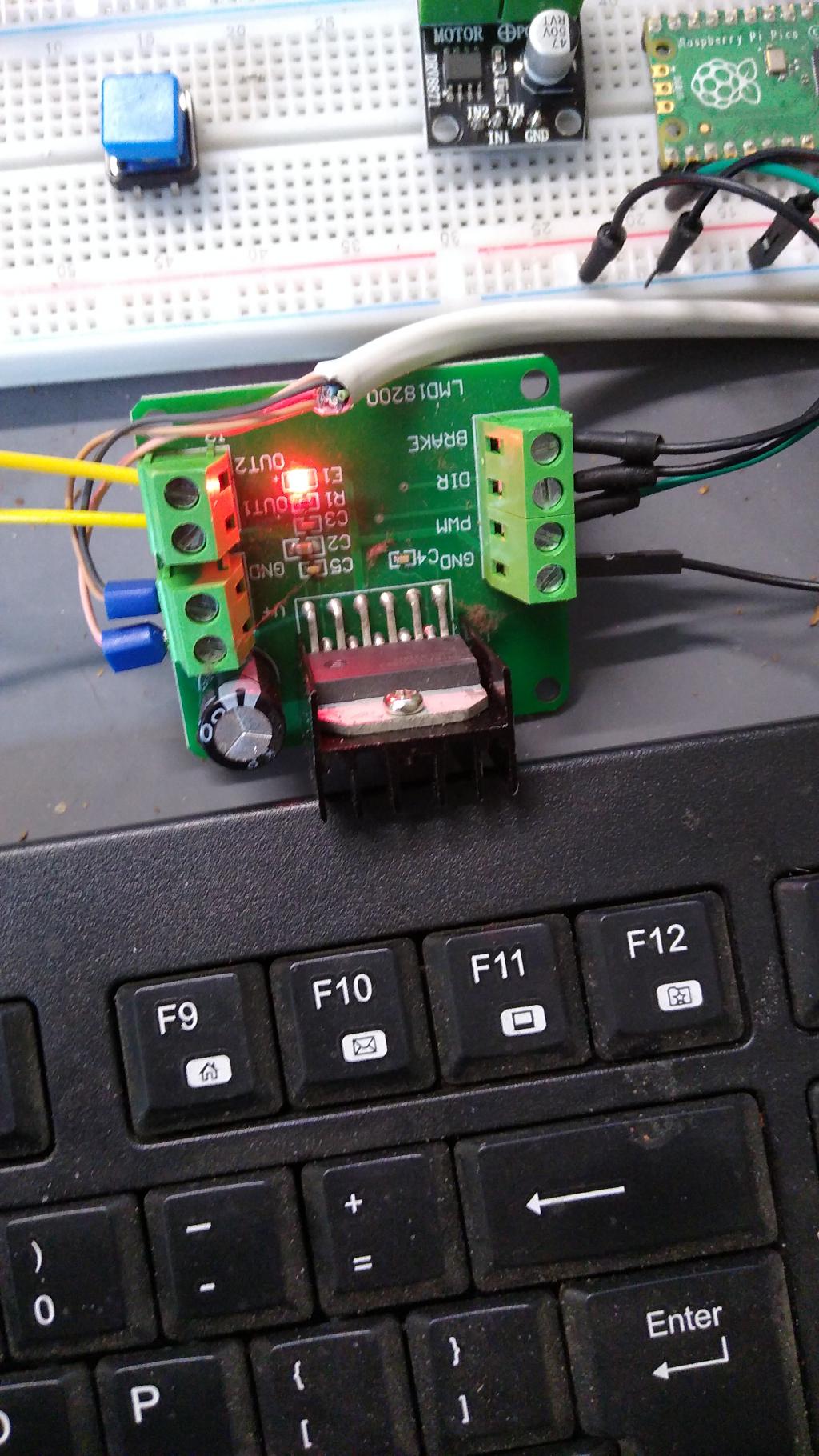

I'm messing with the seat-heater that we discussed elsewhere.
Using the Picomite PWM to drive a LMD18200. Every time I would try to change the PWM value from the terminal, the USB would be dead. Everything is hunky dory with the other PSU
