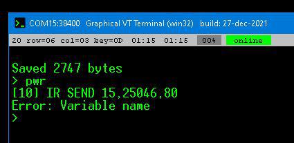

Manual says IRSEND, but I get an invalid command error to that.
IR SEND seems more happy, but I still get a "Variable name" error.
What am I doing wrong?
EDIT: Do "dev" and "key" as per the manual page 26, have to be variables?
I would have thought you could just insert actual integer values here, but perhaps I am wrong....

Don't know which version you are using but 25046 is invalid. Should be between 0 and 31

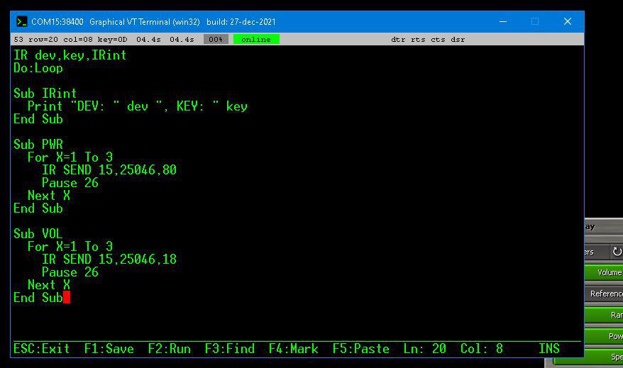

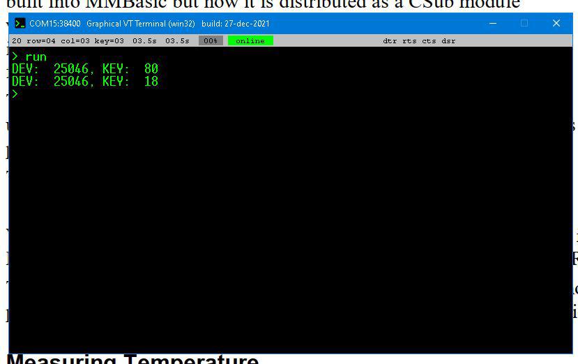

Posted: 09:12am 30 May 2022
25046 is what was reported by the examine code in the manual:
Oh, BTW, Micromite2 firmware 5.0408
Perhaps I need to update if there is a newer version?

Posted: 10:17am 30 May 2022
IR SEND uses the sony 12-bit code. 5-bits for the dev (0-31) and 7 for the key (0-127). Receive can also receive NEC codes
