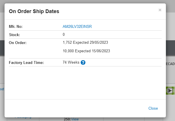

Look at AM26LV32E. This is a quad high speed diff line receiver (32MHz) for 3.3V
No need for level shifter....

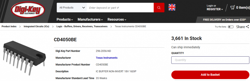

I have lots of pending orders for my controller and so the big problem right now is to design with components that are not in short supply:
-Propeller P2...no problem
-Pico...no problem
-Older DIP devices...no problem
Stuff that I would ideally like to use:
Problem
Craig
Posted: 09:57am 30 May 2022
if you can live with 10MHz (still pretty bleedin' quick) 74VHC240 in stock and available at many sources https://www.ebay.co.uk/sch/i.html?_from=R40&_trksid=p2380057.m570.l1313&_nkw=74vhc240&_sacat=0
Tinine
Joined: 30/03/2016
Posts: 1646
Posted: 10:23am 30 May 2022
For a line-receiver, I'm really comfortable with the MC3486, been using it for years. For the level-shift, the big suppliers have plenty of CD4050Bs. I don't see much risk, here
Craig
