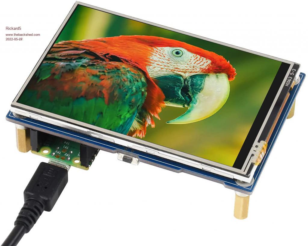

are you talking about this one with the Pico socket on the back?
OPTION LCDPANEL ILI9488W, LANDSCAPE,GP8,GP15,GP9,GP13
OPTION TOUCH GP16,GP17
This One .....

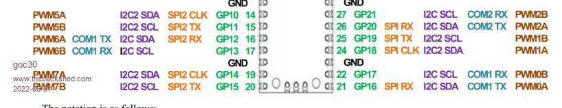

for info pinout Pico with some cards

SD cards are a pain. :) They can have 2 interfaces, SDIO and SPI. MMBasic doesn't support SDIO.
micro Card pinouts
Pin   SDIO       SPI
1     DAT2       X
2     CD/DAT3    CS
3     CMD        DI (MOSI)
4     VDD        VDD
5     CLK        SCLK
6     VSS        VSS
7     DAT0       DO (MOSI)
8     DAT1       X
So you want
OPTION SDCARD GP21, GP5, GP18, GP19
...if I've figured it out right. :)
The audio output from the PicoMite is PWM stereo. It has a fixed frequency and the mark-space ratio carries the audio data. This may not work well with a passive buzzer, it depends if the mechanical inertia will act as a mechanical filter to remove the carrier frequency. You can try it, but I doubt if you'll have much success. You have to define both A and B channels of a PWM port though, even if you only use one.
The best way is to give it a simple square wave, but the frequency range it can manage is very narrow and is usually around 2400Hz. It's not suitable for playing "normal" music if that's what you had in mind.
