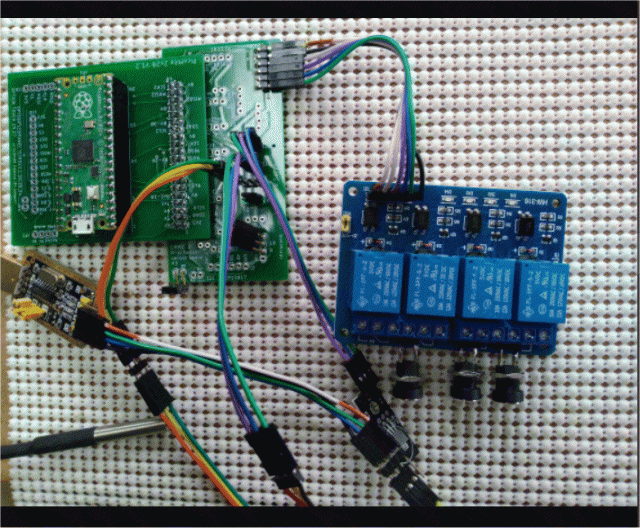

I have a picomite rigged with a 4-relay module (3 being used to turn on 12V LEDs) and two DS18B20 temperature sensors.

Here's the code for MMB4L (or MMBasic DOS or MMB4L or other picomite or serial outputter):

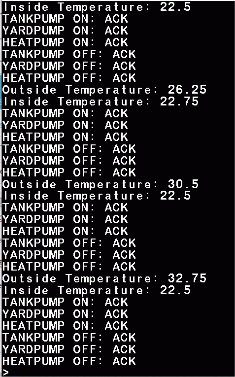

Here's the output on the MMB3W side:
Note the "Outside Temperature" changing as I held the waterproof DS18B20.
If the command sent to the picomite sets the value of s$, then that value is returned. Otherwise, "ACK" is returned for success and "NAK" for failure of the command. Here's the output on the MMB4W side:

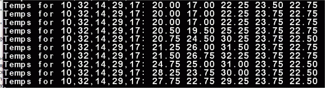

Here's the controller program:
' testSerCliTemps.bas ' test serial client picomite from MMBasic for Windows
const nTemps=5
dim integer pTemps(5)=(0,10,32,14,29,17)
open "com14:115200" as #1
pause 500
print #1,"nTemps=5"
pause 100
print #1,"dim integer pTemps(5)=(0,10,32,14,29,17)"
do
 do while loc(#1)>0: a$=input$(255,#1): loop ' synchronize
 print #1,"readTemps"
 pause 1100 ' allow temperatures to be read
 if loc(#1)>0 then
   line input #1,a$
   ?"Temps for 10,32,14,29,17: "+a$
 endif
 pause 5000
loop
And the serial input returned to the controller:
You can see the temperatures rising and falling as I hold or release the sensors.

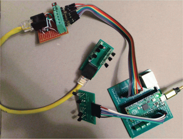

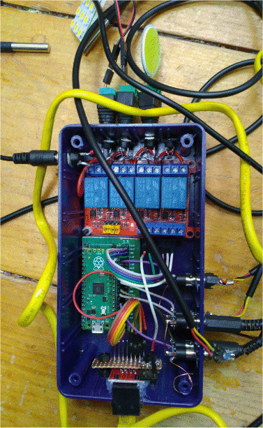

Here's another way to do this--no program at all on the PicoMite client--just MMBasic. Your MMB4W program just acts like a user by supplying commands at the ">" prompt, and interpreting the result.
I set up serial console and connected through 10' of Cat5 with a couple of RJ45 breakout connectors. I used Mixtel90's picomite with 20x2 header, cut out of his "pear" pcb:
This picomite is in a box with a 4-relay module. In addition to the RJ45 connector, the box has 4 power panel mount jack for the relays plus another for the voltage switched by the relays, and 5 panel mount 3.5mm stereo audio jacks for DS18B20 sensors.
I don't have any notable skill as a machinist, even in plastic, but it does work:
The program defines the four pins controlling the relays and sends a SETPIN command for it. Then in an infinite loop it sends a command to randomly turn on or off one of the 4 relays, and to print the 5 temperatures ("? TEMPR(pin#)") separated by a space each. With FIELD$, the program breaks out the temperatures, formats them with 3 decimal points, prints them, and then pauses for 2 seconds.

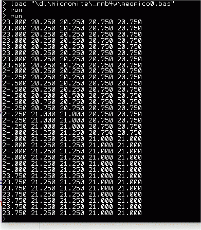

Here's the output; you can see the temperatures change as I touch and release the waterproof sensors:
Here's a youtube video--not much action except for the relays randomly turning on and off 12V LEDs.
Picomite box 4 relays, 5 DS18B20s, MMB4W controlled
Of course, the control program wouldn't have to be on MMB4W--it could be on another Picomite or micromite, or on MMB4L, or on any device with serial output (rewritten for that device).
I plan to test this soon with 50' of CAT5. Wondering if it will still work at 3V3.

  lizby said  I set up serial console and connected through 10' of Cat5 with a couple of RJ45 breakout connectors. I used Mixtel90's picomite with 20x2 header, cut out of his "pear" pcb:
That's a really nice looking box. Just what is needed in a dusty, damp, dirty cellar!
  lizby said  I don't have any notable skill as a machinist, even in plastic, but it does work:

  lizby said  I plan to test this soon with 50' of CAT5. Wondering if it will still work at 3V3.
I think I remember something about needing to send a separate 3.3v conductor to each sensor instead of using a pull-up resistor to power it using phantom power. It should work that way.

Paul--it was late when I posted this, or I would have emailed you about it. I see you're keeping up with the forum.
Yes, this is a working mock-up for your geothermal HVAC system (cooling side). I need to add the panel mount 3.5mm audio jacks for 2 more DS18B20s (yes, they are powered from 3V3 on the tip-sleeve-ring audio plugs (3V3, signal, 0V), not parasitically), and two panel mount power jacks for 5V from the motor on/off sensors, and I think the box contains what you have specified for hardware.
Several people have testified that MMB4W runs well under WINE on Linux, but there is also nothing about the controller program which would not run straight up with MMB4L. However, if you want to add graphical stuff you need MMB4W. Or you can use PC drawing characters like this (though I don't remember whether MMB4L supports DEFINEFONT):
Regarding a spare, I was thinking of an entire separate box. A lot of unplugging and plugging because, no, it would not be easy to replace that relay board. That one was what I had on hand; I've ordered these 4-ch SSRs (a little smaller--no idea how they'd compare for reliability):

Just a couple of points for a control system installed in a cellar.
I'd recommend using two boxes gasketed together with the various connections going between them. The lower box is then just a cable box, but it keeps dust and dirt out of the connectors. Cables could enter ffrom the bottom or both ends. The upper box contains the electronics and has no outward holes in it at all. In fact, it could even be sealed with silicone. It would be possible to fit a window over a small LCD display or some LEDs for local monitoring. The boxes should be screwed together and the complete assembly fitted to the wall with gaskets and silicon sealant  at any screw holes to keep damp out. The PicoMite could be mounted with the USB socket downwards and accessible from the cable box.
Personally I'd like to see a third box with a door-interlocked mains isolator on it and containing SSRs protected by individual fuses (which are also individual isolation devices). A multicore cable would connect it to the control box. The mains box can then be safely earthed if it's metal and, as the SSRs will have opto-isolated inputs, there is no danger of getting mains near the PicoMite. Most SSRs will work from 3V3 inputs now, but you could just feed the PicoMite box at 5V (it produces its own 3V3) and use small mosfets or transistors to drive the SSD inputs from that supply.
If full rating SSRs aren't viable because of the loads then I'd still recommend using small ones and mains coils on the contactors. Adding a 28V supply is adding another layer that can go wrong, and the less mechanical contacts the better.
If the RIBU relays are essential, then I'd use 5V (some 6V ones will also work) telecoms-type relays to power them from 120V. These little relays are standardised, easy to get and cheap. Many of them are rated up to 250V AC, but at that the current needs to be low (which it is here - only 30mA). They can't be driven directly by a PicoMite, but the5V supply is there.

Re flashing the picomite: as presently configured in the box, this right angle "up" micro usb cable could be left plugged in to the picomite and dangling out of the box,
micro usb right angle up cable
But I see no likely circumstance in which the picomite would need to be reflashed with the MMBasic firmware, since all the picomite will be doing is turning 4 pins on and off, reading the status of 2 pins, and reading 7 (or more) DS18B20 sensors.
Re loading an MMBasic program to the picomite, the last posting of code required no MMBasic user program whatsoever on the picomite--the MMB4W program sends MMBasic commands to the console prompt to be executed. However, since the console prompt is what is available via serial, you could simply shut down the MMB4L program, start TeraTerm and connect it to the serial port, and you would have the ">" prompt. From that point, AUTOSAVE and pasting in a program and terminating with Ctrl+z would load a program to the picomite. It would survive power cycling.
Re the relays, I put them in since you had indicated that 28V AC would need to be switched to turn on/off the 120V AC motor relays. If, as you say, they can also be switched with 12V DC, I would be much happier to use MOSFETs. These could be mounted on a PCB with the picomite. Or either 12V DC MOSFETs or relay modules could be mounted in a separate box.
As presently configured, the CAT5/6 cable carries 5V from the PC to the box to the VSYS pin, and the switcher on the picomite provides the 3V3 from that. With the relay module, with 3V3 on the DC+ input, only 3 of the 4 relays switched. Providing 5V to that power input allowed all of the relays to switch with the 3V3 signals from the picomite.

In the photo there are 5 3.5mm 3-connector jacks on the lower right, with holes drilled for 9 (3 columns of 3 jacks). I've since added 2 more for a total of 7 (9 available).

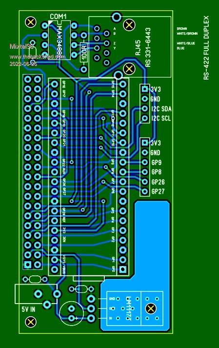

Here's a version which more nearly aligns with Paul's specifications. The pins for the relays (for pumps) and temperature sensors and other inputs are named rationally for his application (pYARDFEED, pYARDRTRN, pTANKFEED, pTANKRTRN, pTANKCNTR, pOUTSIDE, pINSIDE, pYARDPUMP, pTANKPUMP, pHVAC, pYARDRUNNING, pTANKRUNNING):

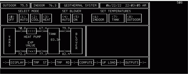

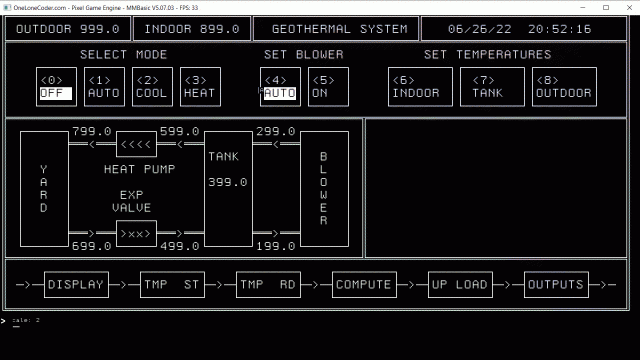

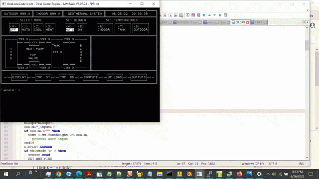

Here's the latest iteration, using Paul_L's PC graphics character display and running on MMBasic for Windows while reading 10 DS18B20 sensors on a Picomite which has no user code--just the MMBasic firmware:
(The "508" in the upper right corner indicates that the program has completed 508 main loops.)
This is essentially throttled by the time it takes to complete a TEMPR START on the Picomite (around 800ms with a resolution of 1/16 degree C), so the MMB4W code only calls on the picomite when the seconds of a time$ call changes. In practice, the temperatures update every second (all 10 sensors), but about once every 8 seconds the time (HH:MM:SS) shown on the second line of the display skips a second.
This is the hardware for test purposes. When I put a finger on a DS18B20, the changes in temperature are reflected in about a second.
I note that there's a spurious zero in the tank center reading. I suspect that's because of a reading of 1000 at some point. I will be checking for readings of 1000 (generally "not connected", but can be spurious) or 85 (probably missing pullup) and logging them.
The code is now 373 lines long--too long to be appropriate for a CODE box, so I've attached the program. The program lacks all of the control code--what to do regarding setting relays as a result of reading these temperatures.
G9.zip
