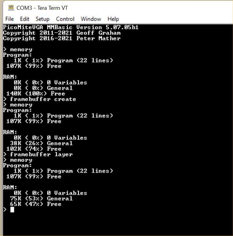

Posted: 11:43am 22 May 2022
  matherp said  Code for second demo
... OK, that looks like you've found enough memory to double-buffer the screen ? I'm assuming that's using 320 x 240 / 2 / 1024 = 37.5 K of the variable RAM.
Or am I making a fool of myself ?

These are excellent enhancements.
For the layers, I can imagine often only one colour might be needed per layer. So borrowing from the Mode 1 Tiles idea, could the option of assigning a single colour to each layer be available to save memory? Or is that pushing things too far?
