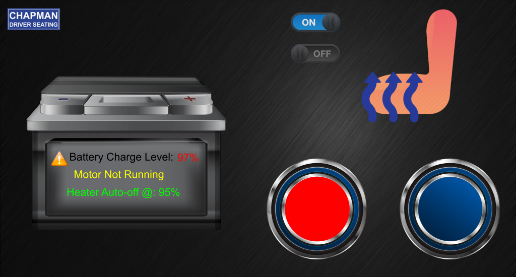

@Mick: Client needs to be able to play with parameters such as PID gains and whatever timers we come up with. I was also thinking about some form of power-setting indicator.
They are talking an initial order of 200 units and so I'll insist on a downpayment that would cover all components.
Of course, I got carried away and proposed a mobile-device/Bluetooth controller but I think that was a bit much for them
Rough idea:

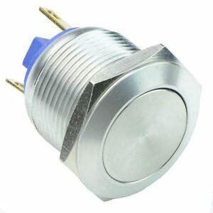

It's the old game of coming up with something that's their own brand. I mean, this will probably be a stainless-steel enclosure with laser engraving...they have all the equipment for this and any knobs or pushbuttons must be rugged:

Oh heck, now I'm in trouble because the client is all excited
All I suggested was a single button and few LEDs to indicate the power level.
He agrees that all-or-nothing power is not the way to go...so PWM it is
PicoMite is overkill but I love it
Craig
