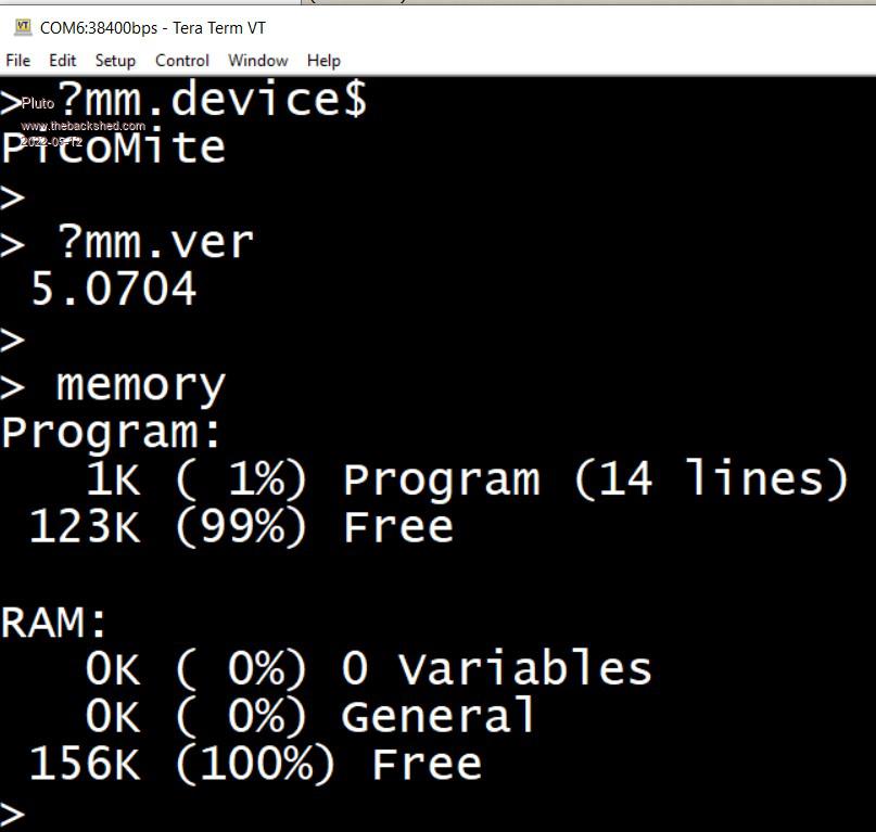

Got today YD-RP2040 made by WWW.VCC-GND.COM from Ali Express.

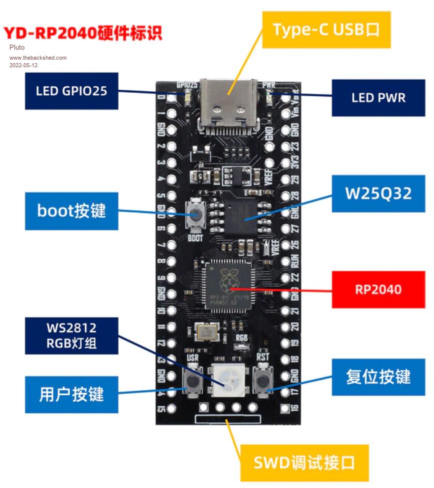

Notable features of the VCC-GND Studio YD-RP2040 when compared to the Raspberry Pi Pico are:
Power LED
Type-C USB connector
Reset button (GP24)
User button
WS2812 RGB LED (GP23)
4MB of flash
Tested very briefly. At least I got the WS2814 RGB LED working as expected.

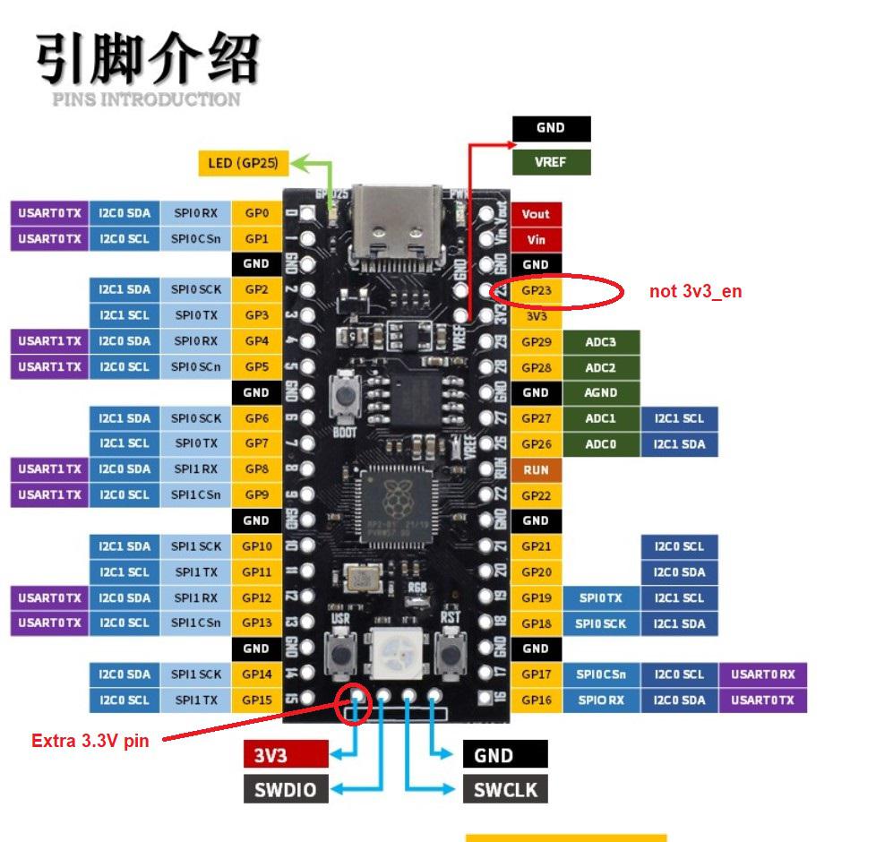

  Quote  Drawbacks compared to "normal" Pico?
Not pin compatible - beware
lew247
Joined: 23/12/2015
Posts: 1709
Posted: 07:12am 12 May 2022
The only difference is pin 37 is GP23 instead of 3v3_en
and an extra 3.3v pin on the bottom edge of the board next to the SDIO pin
it's now only $4.6o including postage

I've used the YD-RP2040 for a while. It seems to be a pretty well thought out alternative but you have to be aware of several points:
The WS2812 needs to be enabled via a solder blob link. If you don't enable it then GP23 can be used as an IO pin.
VREF also needs to be enabled via a link. By default the ADC pins are all digital. Alternatively you can also inject your own VREF via a flying lead.
The maximum speed I've managed to clock them is 252MHz. They work fine for VGA.
As the regulator is analogue there is no 3V3EN. That pin is used by GP29.
The supply pins are different. The VBUS diode is always in circuit and VBUS isn't available. This makes it unsuitable for USB systems. The diode goes from the USB VBUS to VOUT'
VIN has another diode to VOUT. It's very good as a standby supply pin.
The USB D+ and D- connections are not available, which also makes it unsuitable for USB systems.
I think that's about it. There is a circuit diagram available.

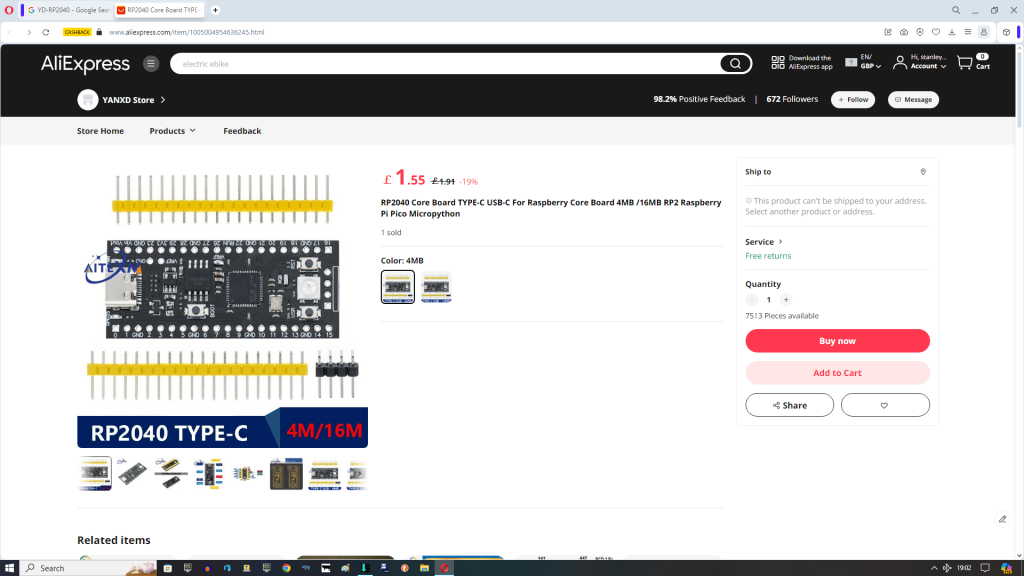

Hi All,
I have been looking at this board (and the purple one) for a while now, mainly as an easy way to access the extra IO pins not normally accessible to a standard Pico.
Using your link I see the price for the 16MB version was down to $3.02AU, albeit the postage was $5.72AU but that doesn’t change at least up to 10 boards.
I decided to buy 5 of them for a grand total of $22.75AU including Aus taxes and postage. Or $4.55AU each, well worth the price to have a bit of a play with them.
I see they use a linear power supply rated at 350mA, I am not sure how hot it would get at that load, maybe it might need some form of heat sink (what could fit that small package?)
I baulked earlier because I was confused by the terminology VIN and Vout, thanks to the PDF schematic that is very plain and I like the concept as I tend to use a 2.1mm barrel jack as the main power source and need to add a diode in series and connect to Vsys to avoid power supply conflicts. This board has that nice dual input diode onboard.
As to maximum speed, looking at the manual (unless mine is outdated) the ‘general’ max clock is 252000, the 378000 does work but not documented so that limitation will not be critical in many applications.
A question, with the 16MB memory will MMBasic automatically detect that and use it or is having that much currently a waste?
