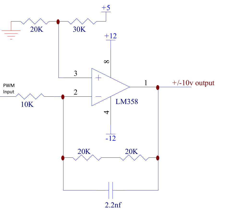

Question for the analogue/analog experts:
The following has served me well on a 5V system. Will I need to change component values for the same to work on 3.3V?
Don't have all of the components with me so can't test.
Craig

Thinking: Switch the 10K to 6.6K and limit the PWM to keep within +/- 10V.

I just experimented on Circuit Simulator. First experiments indicate changing the lower half of the potential divider from 20k to 6k8, feeding it from 3V3 instead of 5V.
Not had time to go further.

  Mixtel90 said  I just experimented on Circuit Simulator. First experiments indicate changing the lower half of the potential divider from 20k to 6k8, feeding it from 3V3 instead of 5V.
Oh Cool...Thanks again buddy
Just out of curiosity, what do you get if you switch the two series 20K resistors for a 33K and a 27K?

You go from 40k to 60k, so you get +/-15v out. Which will not be possible when powered from 12v
Better use 18k and 22k

Circuit Simulator isn't truly realistic (it's an ideal op-amp and a roughly simulated capacitor), but it's showing that the output is +12 down to -10 for duty cycles of 0.1% to 99.9%. That's approximately the same as the original circuit showed IIRC. I went for a freequency of 1kHz, but that only affects the quality of the output for a given capacitor.

If you change the 30k to 26.15k (file the end off a 27k) that will give a voltage of 1.43 at +ve input and -ve input.
Then change the 20k + 20k to 60k (27k + 33k) it should give you what you want.
Good luck
Peter
And change 5V to 3.3V.
Edited 2022-05-12 12:50 by PeterB

The important parts are 1.43V on +ve input and 60k for the gain. If these are wrong you will get a wrong answer. Would you like me to calculate what would result from just the 26k adjustment?
Peter
Ein = 3.3V Eout = -6V
Ein = 0V   Eout = 7.15V
That all assumes I remember Ohm's Law.

Seriously, what sort of precision are you after? Are you wanting to convert 3.3 volts PWM signal to */- 10 volts?
Assuming 3.3 volts:
Set the + side of the op amp at 1/2 that with a resistor divider. Easy to do with two equal values of resistors in series across the 3.3 volt supply.
Not sure what the range of (filtered) output voltage you will get from the PWM - say: 0.3 to 3.0 volts. That is +/- 1.35 volts swing either side of the middle of 3.3 volts (1.65 volts)
You now want the op amp gain to be 10/1.35 or 7.4. Choose the input resistor that you want, say the 10k in your circuit and make the feedback resistor 7.4 times that value.
Try 75k for a start.
PS use a trim pot instead of a file to adjust the value if you need to.

To correct 27K to 26.15 no need for a surface grinder or file just stick a 820k in parallel.
Bill.
I'm not sure your idea will work.
Peter
Posts: 3418
Posted: 06:00am 12 May 2022
To get that accuracy don't forget the pico pin impedance is in series with the 10k. It's about 40 - 50R, so the resistor will need a little elasticity! (1M trim-pot instead of 820k perhaps?)

Yeah, from my know-nothing-about-opamps view, the original circuit has a gain of 4 and with a max input of 5V, 4 * 5V = 20V (range)
60K of feedback = a gain of 6 and so 6 * 3.3 = near-enough.

I think your idea fails because with 1.65V on the +ve input, there must also be 1.65V on the -ve input.
So then the voltage across the 10k is Ein - 1.65 and for Ein = 1.65, Eout must be 1.65 since no current can flow.
There was a time when I was quite good at this but today I have used up my supply of scrap paper just trying to work out how to work it out.
I had to remember simultaneous equations ????????

Hi Peter,
You're correct of course. 1.65 volts is the new zero so the swing will be about that. I also used to be good at this but I've killed too many brain cells.
