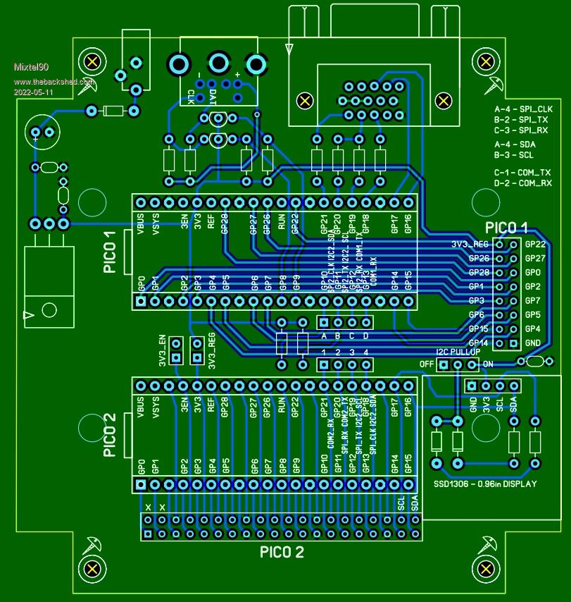

Twin PicoMites
Another odd idea that came from some doodling....
PICO1 is a VGA device, with the usual display (simplified) and keyboard. I/O wired out. GP10-GP13 are wired to a 4-way female header, with pullups on GP10 and GP11. It gets it's supply from a linear regulator.
PICO2 is a conventional PicoMite with an optional little SSD1306 display for debugging. All pins wired to a header except VBUS, VSYS. Pins GP18-GP21 are also wired to a female header. This device can be powered from the linear reg if required (Note - I forgot to run 5V to VSYS!).
Links can be put between the two female headers to link the two PicoMites using I2C, COM port or SPI. So, you can use PICO2 as a master, with PICO1 as a slave display with keyboard or you can use PICO1 as a master with PICO2 as expanded I/O. I suppose you could do some sort of parallel processing.
As there are 4 possible pins linking them you could use COM or I2C with interrupt lines in both directions or SPI with a single interrupt (CS isn't needed with a single slave).
I'm not sure what I would use  it for...  :)

Well, folks, we have a release candidate. :)
Welcome to the PicoMite Pear
(I thought Gemini was just too obvious and, anyway, I got the fun of drawing a pear in Sprint Layout 6. :) ).
PPear Construction Pack.zip
A bit like the above drawing but it grew a bit. Like they do.
If anyone else is thinking of mounting one of these displays in a confined space then use one of the drawings on the web, don't measure one. The one I have is a couple of mm smaller in both directions than any of the drawings!

I didn't point it out in the manual, but it's perfectly possible to use a standard PicoMite in the PICO1 position. The VGA output won't work, of course, and the number of I/O pins is restricted, but it will still work and would be ideal for someone wanting a low pin count PicoMite and a full PicoMite on a common PCB. You can turn the keyboard off but you gain nothing as the pins aren't wired out. However, if the keyboard is disabled they are connected to the first I2C port (comms is connected to I2C2) so there may be a possibility for connecting some 5V I2C devices to the PS/2 port.
The main reason that PICO1 doesn't have more I/O wired out is that I ran out of space for the length of the connector. The display gets in the way at the bottom and a pcb mounting pillar under the board gets in the way at the top end. For many people it wouldn't have been useful anyway as the pins would have been connected to the VGA pins anyway.

For those of you who are a little unhappy with bending resistor leads very close to the body, I've just been updating this board to give you an extra 1.27mm on every resistor. It's needed a little creative maneuvering but it's worked - and I think it's neater. :) No other changes.
I'll probably post the new version of the gerbers later today.
EDIT:
Oh, I couldn't resist...
I've included an optional JDY-40 just for fun. Powered from the regulator and with a link to enable it, but the TXD, RXD and SET pins can be linked by the user to wherever they like. Unfortunately, if you want to case this board then you have to chop an unused PCB support out if this is included.
That's delayed the gerbers until tomorrow. :)

Mick--I just soldered the headers for the 2 picomites on the Pear and otherwise only ran a wire from GP12 on Pico1 to GP17 on Pico2 and GP13 to GP16 to provide a serial link.
I plugged in a USB cable to Pico2 and flashed the firmware. When I tried to flash the VGA firmware to Pico1, I didn't get a RPi drive letter. I unplugged the Pico and flashed it with no problem. When I plugged it back in, I got no flashing heartbeat light.
I know you designed this to be powered with the LM1117, but is there something I can do to allow Pico1 to be powered via USB?
And if so, do I just need to run a wire from VBUS on Pico1 to VSYS on Pico2 to have them both powered with the one USB cable plugged into Pico1? I've looked at the schematic, but haven't altogether comprehended it.
UPDATE:
Ok, with a magnifying glass I could see the little tail of a trace which connected GND to 3V3.EN, and with my 3x reading glasses, I managed to scrape through the trace. Now I have a blinking heartbeat led on Pico1.
UPDATE2:
And with VBUS on Pico1 connected to VSYS on Pico2 I have the heartbeat LED on both PicoMites.
