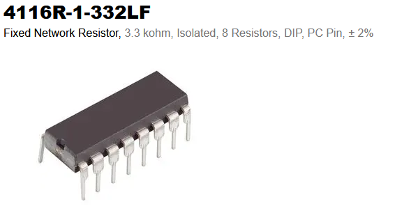

I was looking at 3.3K but I guess, with this format, I can easily test a variety:
