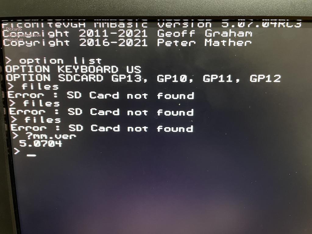

I believe the PM VGA board I'm working with is the V 1.3 Lizby was so Kind to send to send me to build, and it has been the greatest adventure and time machine taking me back to being a Young Maker in Jr. High and High School with 8-bit machines and home brewing electronics, but I digress the only options I've set so far is :
which lead's to another inconvenience the top line is always cut off on ever Monitor I have, butI'm thinking once I get it on the Glass VGA Monitor I can make some size and position adjustments on the monitor

I just updated my firmware and confirmed your Option SDcard command works as expected.
Are you sure the MicroSD card is fully inserted in the slot - the card should only stick out slightly past the edge of the board. Try another MicroSD card? Take a picture of the soldering on the module?
