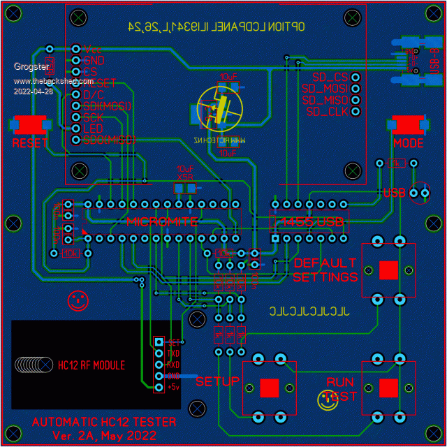

Hi all.
With now even the original manufacturer of the HC12 module being hit with the silicon chip shortage and not being able to obtain genuine chips for their modules, I thought I would design a PCB tester thing, that will allow people to test the modules that they have, from sites such as eBay or AliExpress etc.
There are a ton of modules available on those sites, but are they genuine?
Are they compliant?
This PCB along with a suitable scanner radio(about US$30) will tell you.
The PCB is based on a classic 170 MM2 chip in DIL, along with a 1455 USB chip also in DIL, together with some MMBASIC code that will evaluate the module you have under test automatically.
The PCB will configure any module under test for FU4 mode(long-range, 300bps on-air rate, 1200 baud UART interface) @ channel 1(433.4MHz), then run some transmission tests.  All of this configuration and testing is done via three tact-switch buttons, and a readout of results is via a 2.2" SPI LCD module.
The idea behind setting the HC12 to FU4 mode, is to make most scanner-radios out there able to audibly reproduce the data packet being sent.  At higher baud-rates, many scanner radios CANNOT see the HC12 transmissions, but FU4 @ 1200 baud UART and 300bps actual over-air rate, just about ANY scanner radio can see, and will issue an audible burble when the unit transmits.
Buttons for restoring factory-default, setting the module ready for test, and for performing the actual test.
I have ordered the PCB's, but have yet to write the MMBASIC code.
That's next.
I have 20-odd HC12 modules coming from both eBay and AliExpress sellers.
This code will be released here as both a BAS file and a full MMBASIC+code HEX file when the time comes.
I designed this, as supply of the GENUINE HC12 is now drying up thanks to the global silicon chip shortage now affecting even the manufacturer of the HC12 module now, so you really HAVE to have a way to test if you have genuine or clone modules without any major hassle.
The LCD will tell you what commands it is sending, and when it is transmitting etc, and you will then need to refer to the scanner radio and/or frequency counter as to if the module under test is compliant or not.
Modules that are not, will need to have their crystals removed and replaced with genuine ones from a respected parts house.  That fixes 99% of the clone ones that don't work correctly.

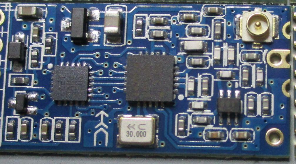

Posted: 01:08pm 29 Apr 2022
One of my parcels of ten units has arrived from AliExpress, and they appear to all be genuine, as they are laser-engraved crystal type - they have the HC logo laser-engraved onto the crystal.
I seriously doubt that the cloners would go to that much trouble - AND COST - to have reject crystals laser-engraved, so this is a good thing.
Genuine HC12 module...
They are well priced at about US$7.50, but are on special at US$6.23 per unit at the moment.  They show 6,425 pcs available at the moment.  I am going to order more from this seller, as they appear to be the genuine article.  Weather that will REMAIN the case is anyone's guess, but for right now....
I have another ten coming from another seller - I will report if these are also laser-engraved crystal ones, or possible clones.  I also still have a small pottle with about twenty-odd confirmed clones in it, so I will use these to test my new board, and then to try to replace the crystal on.

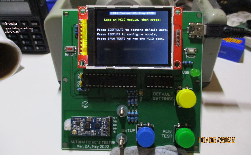

I have the basic unit up and running, and need to clean up my code a bit, but I thought the forums might like some progress photos:
All testing and setup is via simple buttons.

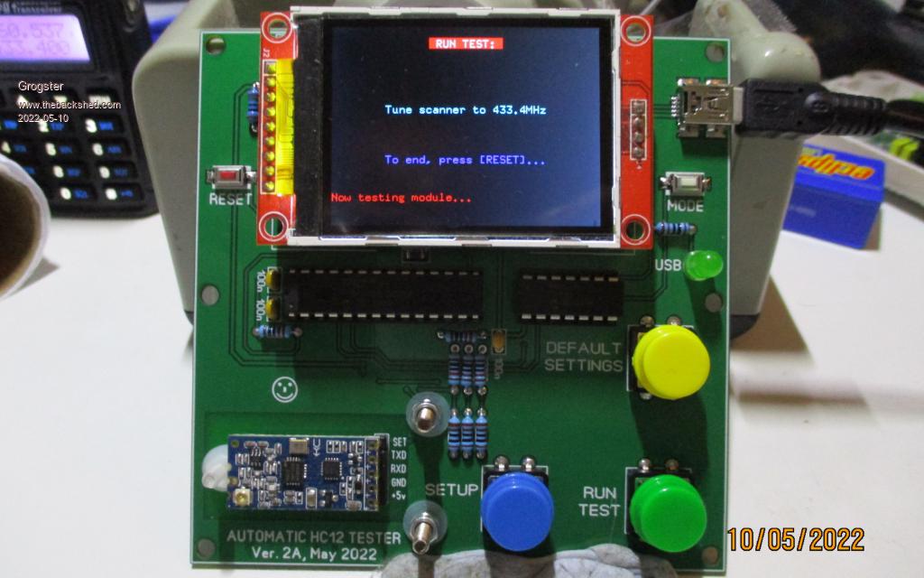

You need a scanner radio able to tune to the test frequency of 433.4MHz

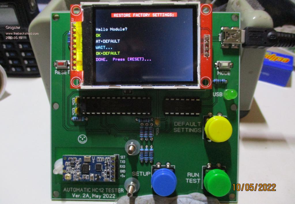

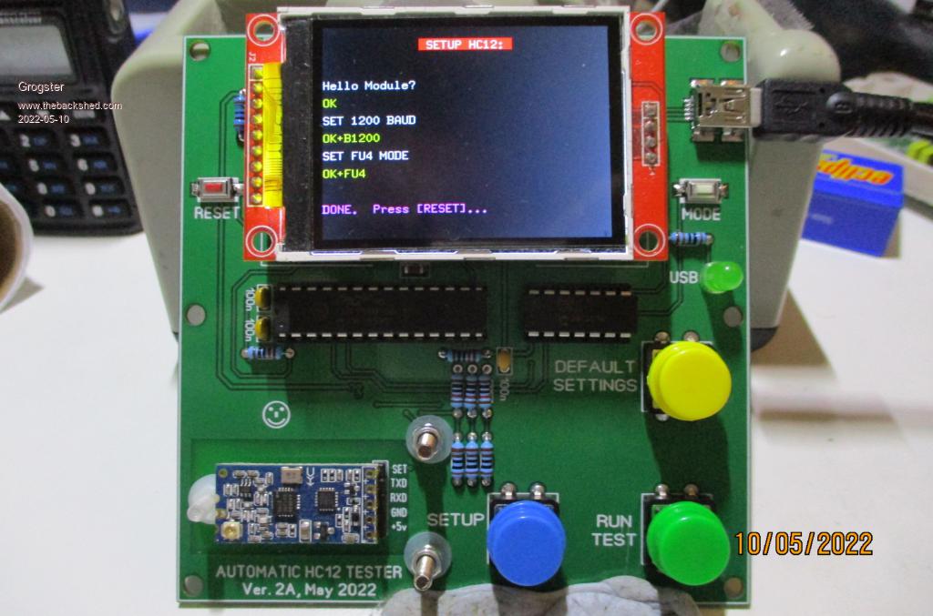

The standard procedure is:
1) Load an HC12 module to test
2) Press the blue SETUP button to configure the module under test
3) Press the green RUN TEST button to run a transmission test
4) Press the yellow DEFAULT SETTINGS button to restore the default settings
The HC12 module under test, is held in place using the module's castellated holes on the edge of the module, and a 3mm nylon bolt and washer mounted in a slot.  The nylon bolt is done up tight in the slot, in the correct position that will provide some compression to the module, and hold it firmly against a gold-plated five-way pin header.  Installing and removing the module, is as easy as insert and push down to install, and lift and remove to take it out.
You COULD use a normal steel 3mm bolt arrangement here, but you would need to be careful not to short the RF out to either of the ground connections beside it, and nylon offers insulation against that, plus a LITTLE bit of pliability over the rigid steel bolt, and it seems to work perfectly.
The entire board is powered from the USB cord, so it is a reasonably compact testing tool with LCD readout of what is going on.  I could have put touch control on this board, but I could not be bothered.  In hindsight, I probably should have, but ah well.....
