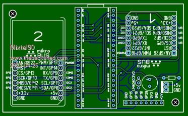

Found the spec on mikro BUS, Craig. Would you like me to see about a PCB? It would probably have 2 sockets as there are two of each sort of interface. It would use up a lot of I/O pins though (20 min.).

Something like this?
  Quote  I have this other thing coming your way and thus far it has 4 Picomites, a Prop-2 and 156 I/O
That's just cruel....   :(

On the Explore-100, the pins are not necessarily tied-up with the Click sockets. They are also brought out to the headers.
The neat thing about these Click modules is that they are tested/proven circuitry and they also provide the module's schematic and sample code in BASIC (albeit MikroBasic).
Simply download the file and unzip it (they have their own file extension but it is actually a zipped file).
Craig
Posts: 9265
Posted: 01:08pm 25 Apr 2022
No prob - nice to see a proper one. :)
I hadn't realised that SPI and I2C could be shared or that RST was individual to the module. I didn't bother with level shifting either - it's 3V3 or don't bother.
I'll not chase it further.

Actually, Mick....
I think I might be interested in a Click socket with one of those tiny 2040 modules...just had a cool idea
