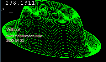

Posts: 6206
Posted: 08:08pm 22 Apr 2022
nice graph...
298ms on MMB4W under WINE on linux (between 200ms and 300ms depending the CPU load)
Edited 2022-04-23 06:14 by Volhout
