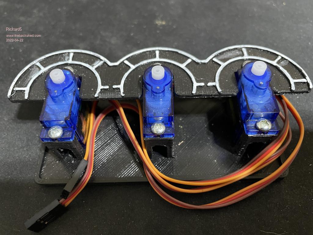

I built this servo fixture to be a physical servo based read out for a project I'm working on, but I'd also like to have a Graphical representation of the gauge cluster on screen as well
if I read correct and I use BLIT since there is no sprites, I have to create a separate Bitmap for every needle position?
