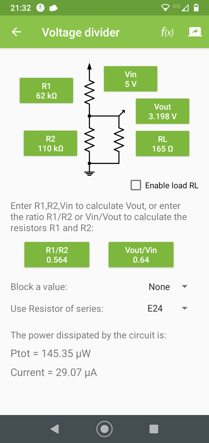

This is from my Android app "Electrodoc" (nice).
Play with combinations that suit what you have in stock or whatever power dissipation you want to shoot for.

I doubt if the Pico input will load that with 165R!
Try 3.3K on top and 6.8K on the bottom to give 3.366V off-load. The Pico input is pretty high resistance but that is safe and will drop a little further.
