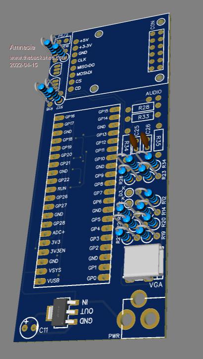

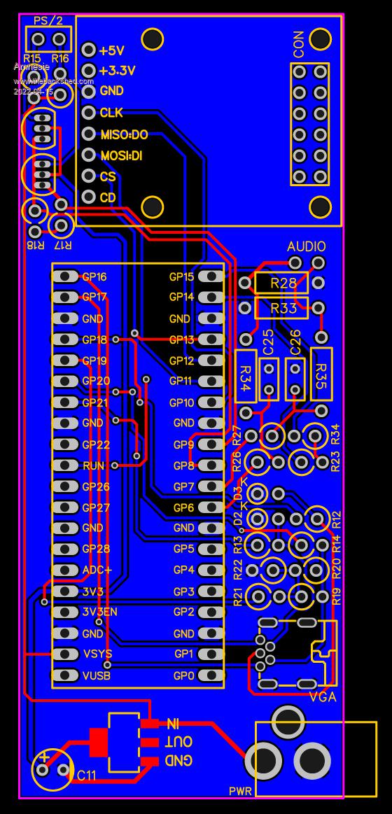

This is how far I got:
DIMENSIONS 39mm * 95mm
Really really tight but I think with this dimensions it is possible, at least to some degree. As we can see we must do some compromise with connectors. Otherwise we must switch to SMD technique instead of through hole components... But this would be a bad soloution so solder.
You can see that there is still more trace routing to come. I quickly explain the sections:
Upper left is the logic shifter for keyboard, right to it is the adafruit micro sd breakout on spacer to fit underneath the 2x6 connector for GPIO. On the right to the PICO is the VGA resistor network as well as on the top the passive audio filter network. And as said, for the moment it is just an idea to show and test some component placement or even the possibility to fit everything. VGA connector can be a different type but MUST be a similar footprint.
I am doing a short break now :)
Greetings
Daniel
Edited 2022-04-15 05:56 by Amnesie

Posted: 11:22pm 14 Apr 2022
Making some progress, I think this is really possible! But as I said; if it should fit in a keyboard it we can not go much bigger, so my suggestion is to fit a VGA connector seperatly or find a good substitute connector which is available (!) on the market.
So far it is on the board:
- RTC (mini version for the RaspberryPi)
- Adafruit Sd breakout on spacer
- PS/2 Keyboard out as Peter suggested via bare pins / connection
 -> Level Shift transistors are correct polarity, I used different type (2N7000)
- Audio via pin connector
- VGA (in search of soloution)
- LDO 3V3 (AMS1117, 800mA)
TODO:
- forgot the 3V3EN
COMPROMISES:
- PICO micro USB not accessible (solution would be to turn the PICO 90 degrees, but this is a no-go, since it would make the overall dimensions not accepptable)
- instead of 40 pin connector I took a 12 pin connector and routed following pins to it:
GP0,GP1,GP2,GP3,GP4,GP5,GP27,GP26,GP22,GND,3V3(on the picture it is GP28, changed that, since 3V3 is more important)
There is and always will be some compromise... Any suggestions so far? :)
Edited 2022-04-15 09:33 by Amnesie

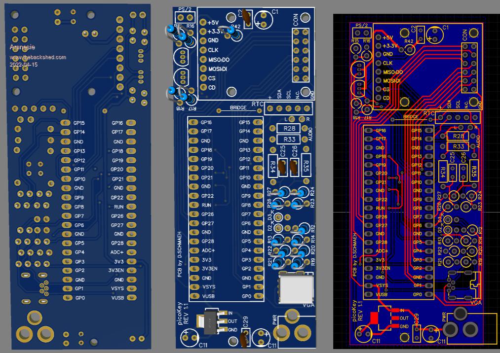

I think a  VESA mount is a different approach, you can not access the GPIO (unless you are willing to accept long wires) etc... The downside of building it into the monitor is, that it isn't as portable as a keyboard. Of course; everything has it's right to life. I think I will end up with different versions. One will be a "as minimal as possible" to maybe fit the inner of a keyboard. The other will support a full VGA DSUB 15. I am working on this right now and moving some components to keep it at a maximum length of 10cm (EDIT: check! It fits)
Even if this won't work out to fit a keyboard we have another two versions of a small footprint picoVGA :)
Edited 2022-04-15 15:23 by Amnesie

Hi Amnesie,
If you need more length than 10cm, design a pair of boards that mate via R/A male & Female header pins and you can join 2 PCBs to make a 20cm long one.
