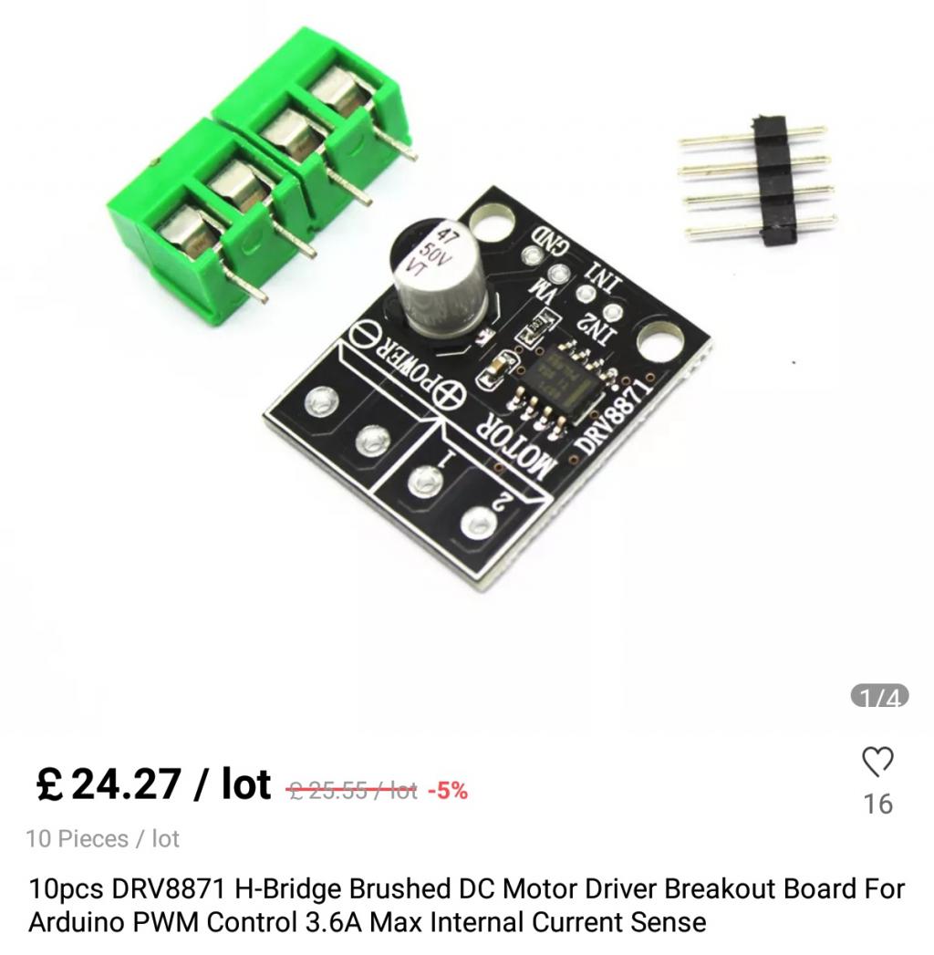

Price has increased on these things. I got 10 for <16 quid:
