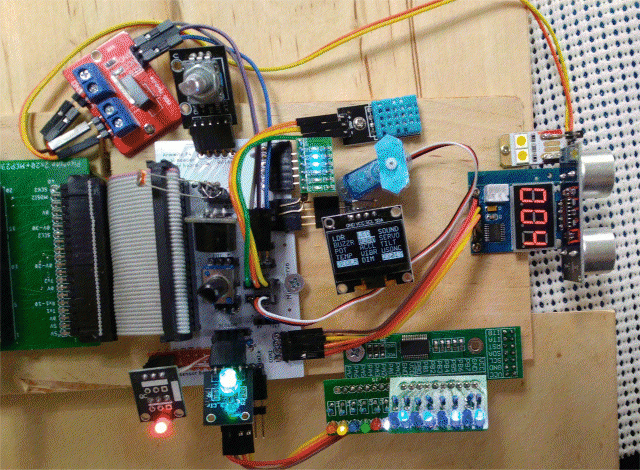

Posted: 12:52pm 31 Mar 2022
Here's a youtube video of the PicoMite doing many things, including LED dimming and brightening, and servo twitching.
Gerbers, code, and other info linked here.
