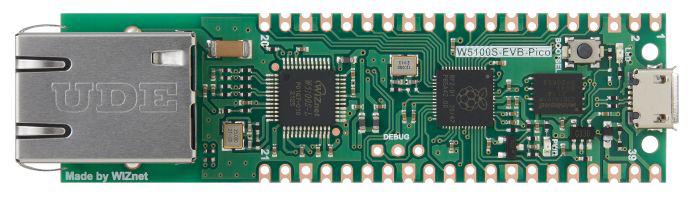

Posted: 12:24am 14 Mar 2022
Interestingly, I note that WIZnet actually make and sell a PICO module, with the ethernet combined on the one unit - clever, and only US$10.
Link...
