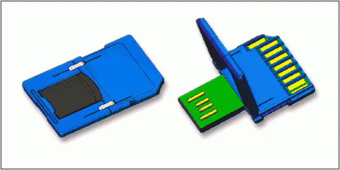

Posted: 03:05pm 11 Mar 2022
1. a card something like this?
see this news item from 2005:
https://www.dpreview.com/articles/3783318788/sandisksdflip
and earlier, in 1999, there were similar CF cards from Lexar:
https://www.dpreview.com/articles/2745487673/jumpshot
as far as i am aware the idea never really took off, and i am not aware of anything similar available today. this is not to say you couldn't 'roll your own'; you just need to combine an SD card with a card reader + relay. when the relay is energized (from the USB 5v rail), the SD card is connected to the reader's electronics. when USB power is absent, the relay drops out and connects the SD card contacts to a cable tethered SD 'plug' that is plugged into your pico.

Posts: 9265
Posted: 03:25pm 11 Mar 2022
I think plasma wants to use a USB stick *instead* of a SDcard, but connected to the same SPI and using the same system. I'm pretty convinced that this is impossible without something else between them, either a computer inits own right (such as a Raspberry Pi) or one of the specialised chips that I referred to earlier. The flip RAM had one RAM chip that was accessed by either the SDcard connector or it could be plugged into a USB port - not the same thing, although it might be usable here it can only be connected to one device and you can't use it with any USB stick.

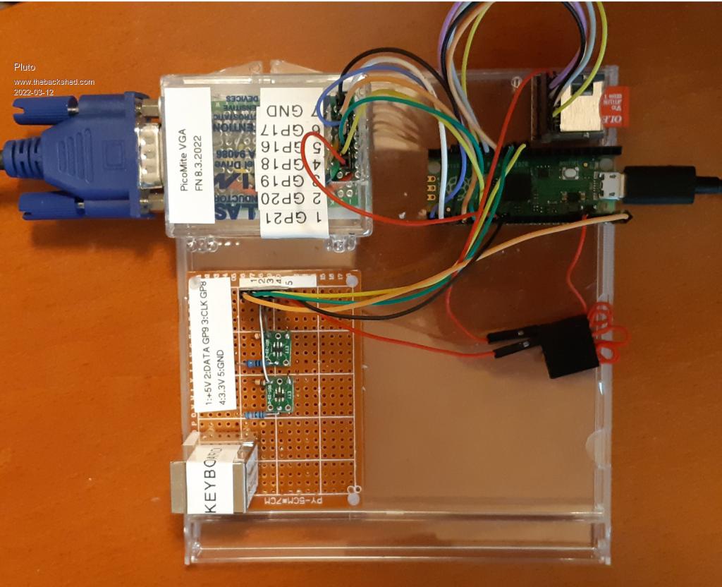

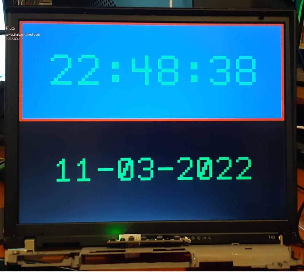

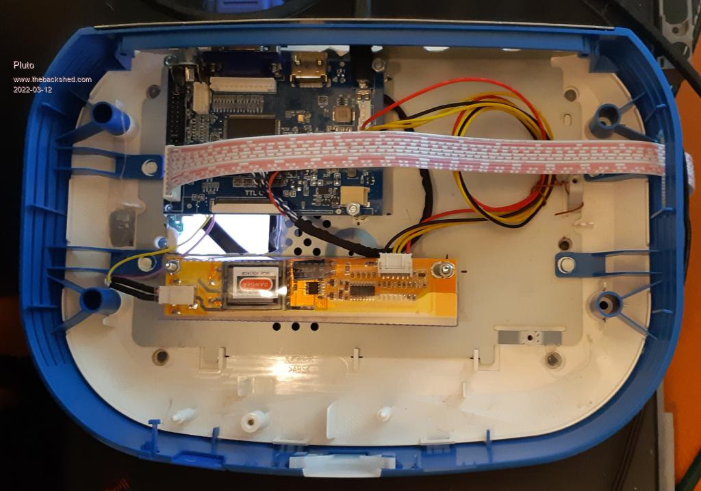

Pluto
Joined: 09/06/2017
Location: Finland
Posts: 421
Posted: 09:31pm 11 Mar 2022
I like to recycle as much as posible. My PicomiteVGA is connected to an old LCD screen from a scrapped IBM laptop.
Inplanted on the display's backside in the enclosure of an old digibox.
The main board with PicoMite and external connection circuits are bolted to an  old DVD envelope.
NB:keyboard not yet tested.
Fully functional @total investment of less than 30USD (Picomite ca $6 + LCD driver ca $21 + SD card holder $0.60 incl freight from China).
Just now connecting to a Geiger-tube module (taken into operation after resting several years in my backshed) for monitoring eventual changes in radiation coming from south-east.  Still normal background levels on my monitor as vell as on the official measurements.
Thanks to MMBasic it is so easy to rapidly implement useful things on demand.

Posted: 10:47pm 11 Mar 2022
I hope you're ashamed of yourself - spending so much on a SD card holder when you could have soldered wires onto a full size SDcard adapter and stuck it down with a glue gun. ;)  That's really good - I'm impressed! I have a couple of old laptops (not IBM), it might be worth investigating their screens.

Posted: 07:31am 12 Mar 2022
I have ordered the LCD driver boards from "Yqwsyxl LCD parts Store" on Ali Express. Just send them the LCD model number and they will propose suitable driver boards for you. Fast response and fast delivery (2 weeks).
