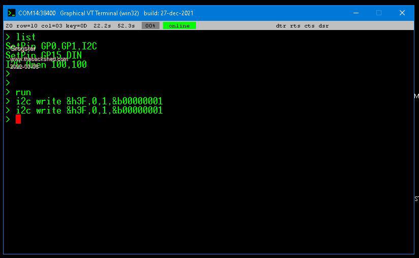

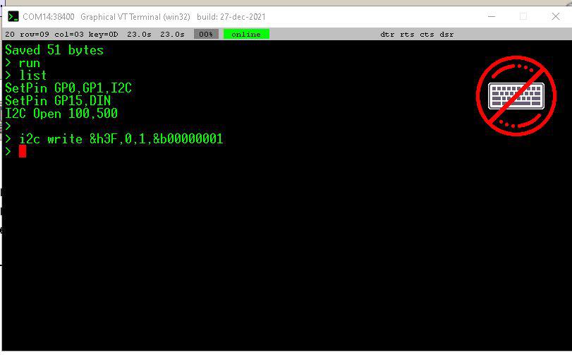

However, when I setup I2C, when I try to send a byte to an I2C slave, all that is ever sent, APPEARS to be the address byte.
My simple testing code.  Set the IC2 pins, open the port.
At the command prompt, I am then experimenting - should I not be doing THIS perhaps?
IE: All I2C commands need to be inside the code?

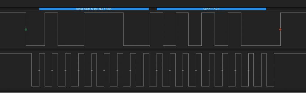

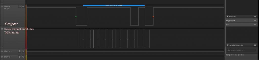

The logic analyzer on the GP0 and GP1 I/O pins only seems to reflect ONE byte, even though I am trying to send TECHNICALLY two bytes - the address and the data byte.
I did not think you needed to count the address byte as part of the payload.
Do I have that wrong?
EDIT: Image is a little fuzzy - White-on-blue decoder info says "Setup Write to (~) + NAK"  Parenthesis uses instead of square brackets, as they are forum formatting flags, but they are square brackets in the image.

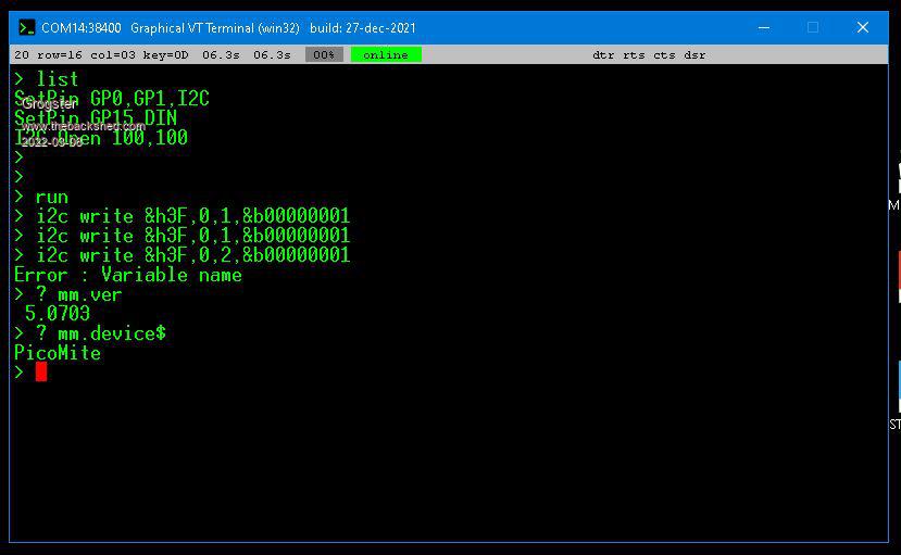

I tried that also here:
....but I got an error message(Variable name), which suggests that what I was doing originally was correct in terms of command formatting.
If I ? MM.I2C, it replies with 1 - NACK.

I would have expected to see TWO bytes in the logic analyzer capture, but we only see one - and it's the wrong slave address.....

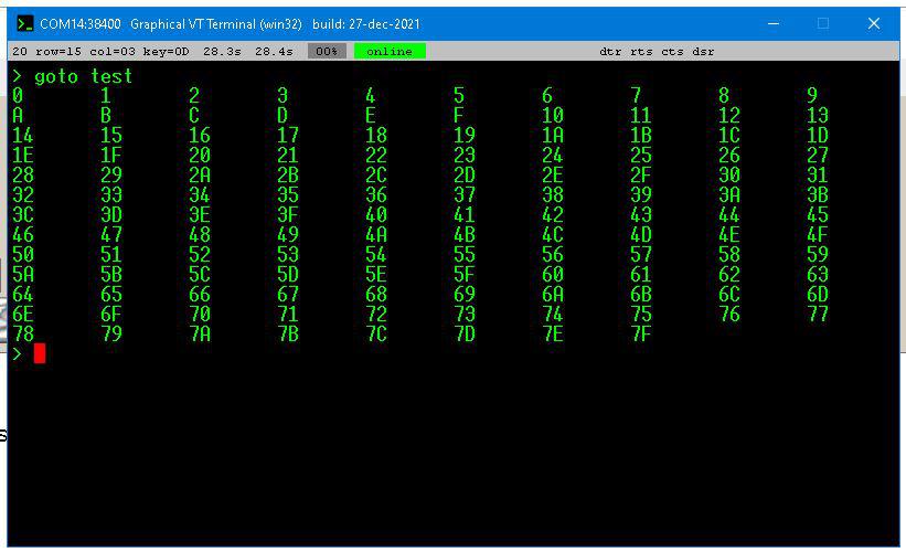

Posted: 10:34am 08 Mar 2022
run the attached - what does it give
setpin gp0,gp1,i2c
i2c open 100,1000
for i=0 to &H7f
i2c write i,0,1,0
if mm.i2c=0 then print hex$(i)
next i

Posted: 10:27pm 08 Mar 2022
Hi chums.
@ matherp: Results:
Not sure if that is what you were hoping to see.
@ Volhout: This chip is a PCF8574T  Not sure if that matters.  PDF does not mention anything at all about the suffix and what it is.  PDF DOES state it is for the A variant though, so perhaps there is another PDF for the non-A suffix part?
@ disco4now: Thanks, I will check out your example code.
I found another PDF from NXP this one, instead of Texas Instruments, and the NXP one has much more technical information in it, so I am reading this PDF now...
PCF8574 I2C port expander(NXP).pdf
Page 5 of THIS PDF gives read, write and 7-bit addresses(without the R/W bit), so it is suggesting that with A0,A1,A2 all high, the slave address is &H27 - totally different to what the TE PDF says for the same part.  Confusing.
I will try with an address of &H27 and see if we get talkies.

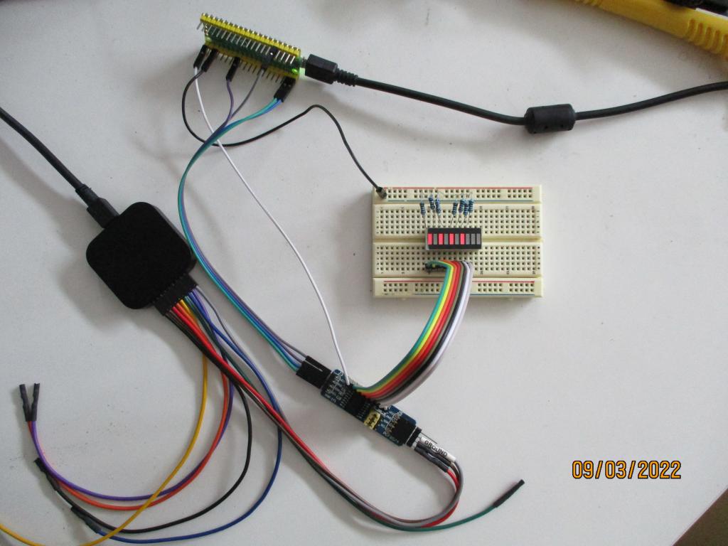

Thanks, Grogs. Here are two PCF8574s toggling LEDs: PCF8574 output to LEDs
Dim integer k1=&b10101010,k2=&b01010101
 I2C write &h38,0,1,k1: I2C write &h39,0,1,k2: Pause 500
 I2C write &h38,0,1,k2: I2C write &h39,0,1,k1: Pause 500
 If Inkey$<>"" Then Exit
I2C write &h38,0,1,255: I2C write &h39,0,1,255 ' turn off
FCF8574s use negative logic, so writing a "1" turns a bit off and writing a "0" turns it on.
