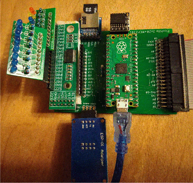

I have also done a Backpack for the Pico - see my post here  - not bragging, just for info. I also like Micks design here - covers just about everything and nice and compact.
I decided to provide support for the SSD1963 based LCDs (5,7,8 inch) as well as the ILI9341 2.8" and ILI9481 3.5". I am not sure why Silicon Chip decided not to have a connector for the SSD family - possibly because they also wanted to keep a foot in the microPython camp.
They didn't include any 8266 support (via headers) either which I found surprising.
Other than that, an interesting take on expanding the Pico.
Doug.

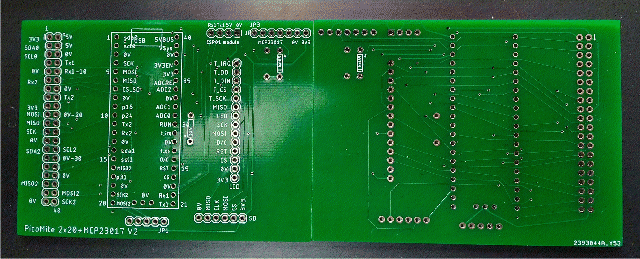

Doug, I like your design and would use it quite happily with a big display. I am also very envious of your workbench and at how astoundingly clear it is.  :)
My backpack was designed to fit into a specific box, hence the restricted size. I also experimented with the design of an intermediate PCB to sandwich between the display and the backpack. It picks up on the I2C pins that are used for the RTC and feeds them to a Micromite to add a whole new set of I/O. This was before I discovered Geoff's code to handle it, so I didn't take the design any further as I expected to have to figure out the software too. lol I might be tempted to work on it again now.

Mixtel90 did a very good backpack for the PicoMite way back when and you can get PCBs for that made up for pennies. If his backpack doesn't suit then I'm sure someone on TBS could design one open-source. It would take me about a day to do a complete design but many of my needs are met by the various commercial offerings already out there fully built and cheap (Waveshare, etc.)
Posted: 01:06pm 28 Feb 2022
  matherp said  I'm sure someone on TBS could design one open-source.
In addition to Mick's and Doug's, there are these Picomite Backpack plus 2x20 breakout PCBs
Gerbers and Eaglecad files linked to. At last check, 5 PCBs from JLCPCB cost under $6US with slow boat shipping.
Edited 2022-02-28 23:07 by lizby

Posts: 9265
Posted: 04:29pm 28 Feb 2022
I have some boards now, but messed up on some of the drilling so I'll need to get another batch. (It's a side effect of being ancient and stupid). I think I've sorted out my mistakes now, but I've just not got round to re-ordering (waiting for my next pension payment!).
The SSD1963 uses rather a lot of pins. As I also wanted the SDcard and a RTC that ate a few more. Consequently the board now has a local I2C network which includes the RTC, a Micromite and a second PicoMite. It piggy-backs behind a 5" display.

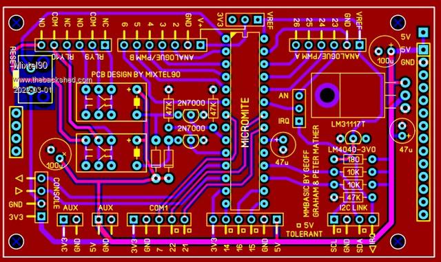

Posted: 08:05pm 28 Feb 2022
If you have any backpack that fits the ILI9341 and you are running out of I/O then this may help. It connects to your main device over I2C and gets its power from the 5V pin of the display. It can also be used as a stand-alone Micromite board by fitting a terminal block with pins on 5.08mm centres instead of the display connectors. The display connectors are the long pin type, fitted from the rear of the pcb. The backpack fits onto the front and the completed assembly fits onto the rear of the display.
This is completely untested other than using the "Test" tool in Sprint Layout.
Comments welcome as usual. No, I'm not going to include wireless connectivity or get rid of the clicky relays. :)
