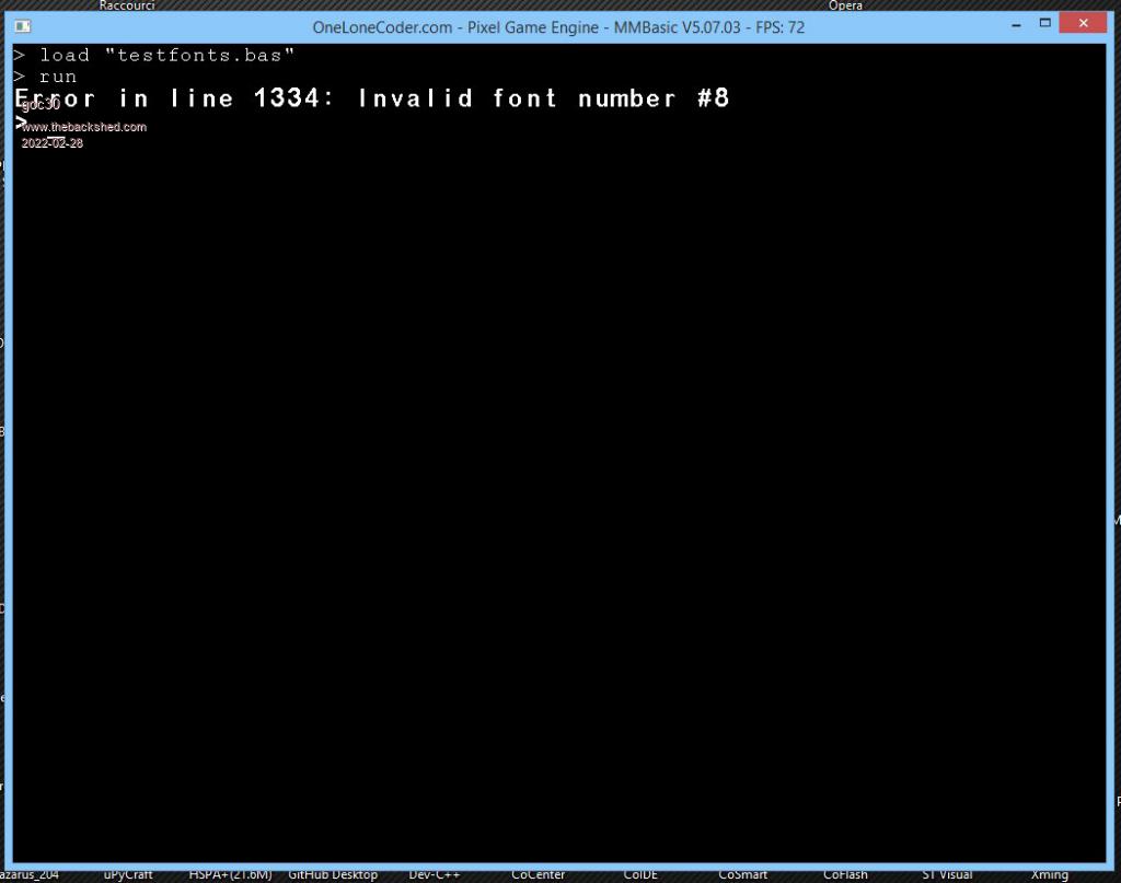

  matherp said  The font issue was a bug - your test now works perfectly on my development version - will post tomorrow.
bug is in this part
for i=1 to nbfonts  'if nbfonts > 7 then it bug
 font i,1
 vsize(i,1)=MM.info(fontwidth)  'dim vsize(16,3) as integer
 vsize(i,2)=MM.info(fontheight)
next i

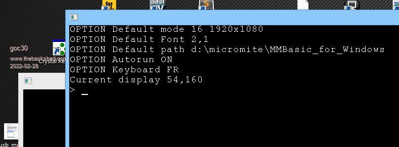

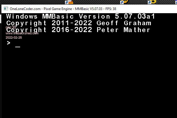

Posted: 11:53pm 27 Feb 2022
  matherp said
The cursor issue is something to do with your set-up. I can't replicate on either a 4K monitor or a single 1080p monitor. Do you have an issue if you use mode 15?
I understood the problem, in fact with win10, I have window edges reduced to the strict minimum, while with win8 I have window edges of standard size
win10
win8

V5.07.03b1
MMBasic.zip
DEFINEFONT now working. I had patched out the code during development and forgot to re-instate

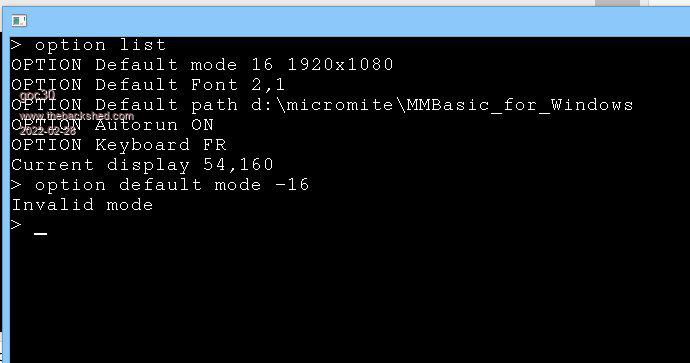

but I have always pb with "option default mode -16" who return same error
Posts: 12058
Posted: 12:50pm 28 Feb 2022
  Quote  but I have always pb with "option default mode -16" who return same error
This is correct. I made the decision not to allow full screen modes to be set as default. Full screen on Windows can be a problem (no access to menu bar etc.) so I thought it better to only allow it to be set once in the application. This is open to discussion but that was my thinking
