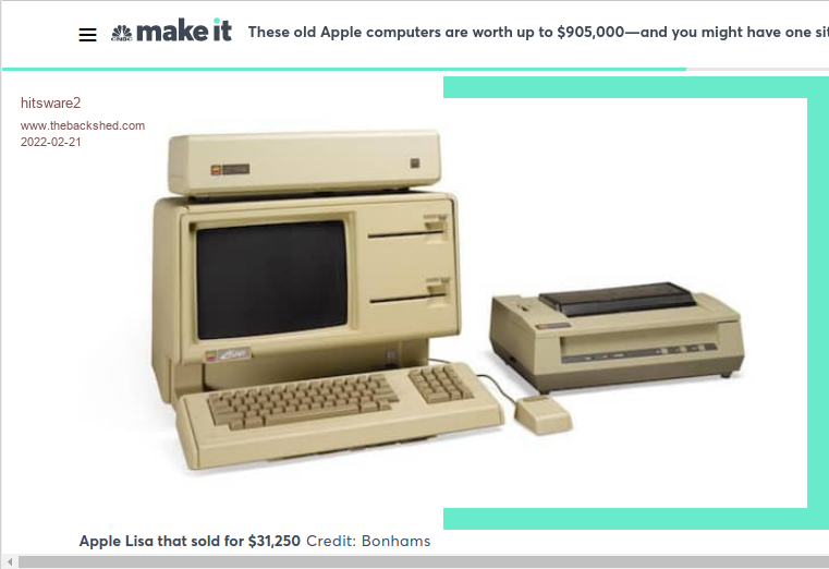

hitsware2
Joined: 03/08/2019
Posts: 738
Posted: 01:03am 21 Feb 2022
