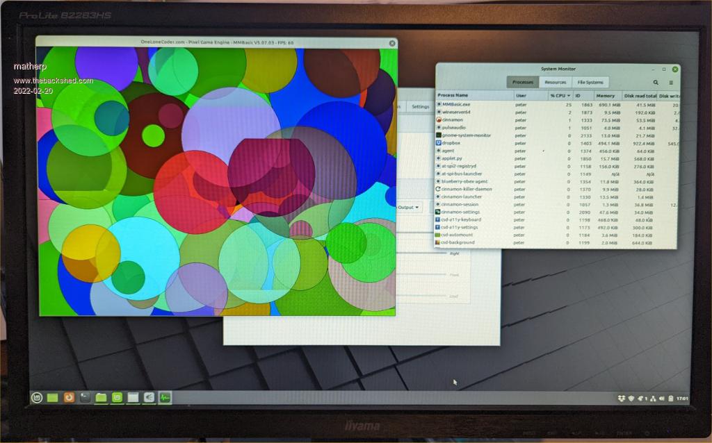

This is on a very old PC (Q9550) with 4Gb Ram running Linux Mint Una Cinnamon.
Based on a very quick test everything appears to work perfectly including sound.
LIST COM PORTS shows 32 ports so not sure what is happening there but one of you Linux type can perhaps explain

Wine pre-loads the folder .wine/dosdevices with links to /dev/ttySx
These can be adapted in windows registry using regedit in wine.
But they exist, and as such may be listed in MMB4W. But that does not say these ports are actually existing in hardware.
