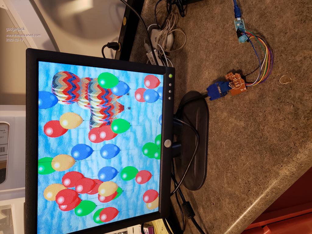

I found this code on https://github.com/Panda381/Pico16VGA. Very simple circuit with lots of sample programs, all drag and drop to load. I have only went through about 4 of the samples but they look pretty good. All 640x480 in 16 colors. He has other works on his page , but have not tried them all yet. Some good stuff for a cold winter day.
