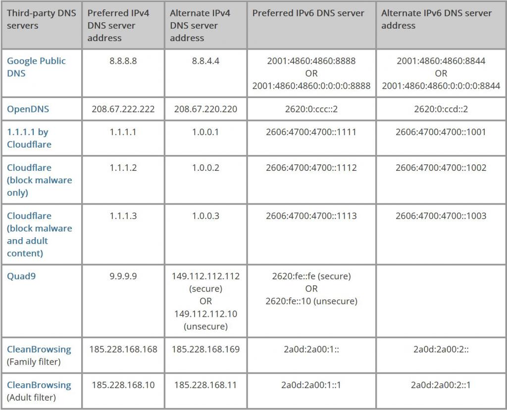

It could be simply that your ISP hasn't enabled IPV6 yet to their DNS servers
It's easy to change it yourself, it's almost the same steps as you did to disable IPV6.
Use one of the many public DNS servers, this is step by step instructions incuding a list of free public DNS servers like this
